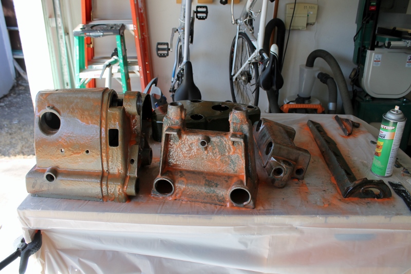

CitriStrip in action (not that you can see the action)
[ATTACH]24202[/ATTACH]

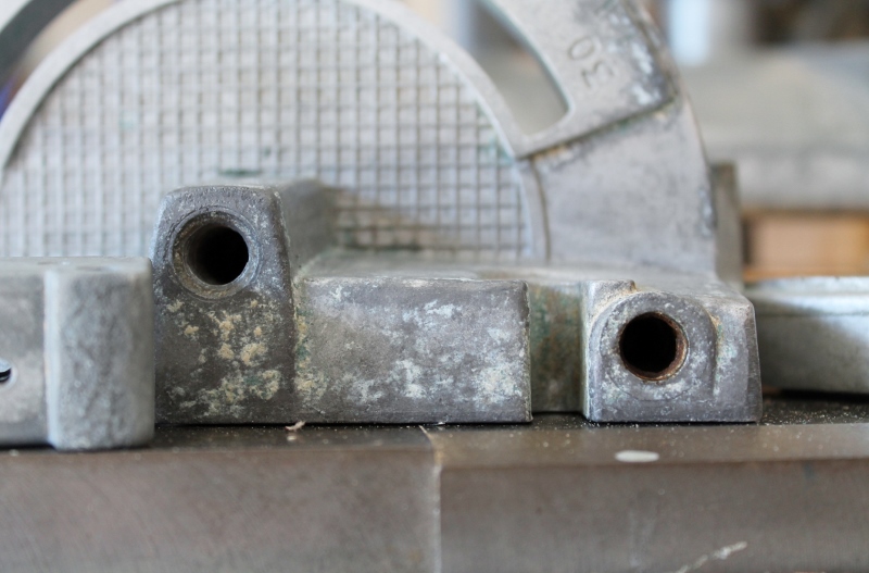

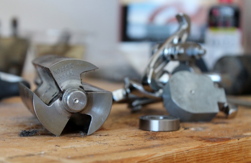

Jointer cutter head. I though this thing was BLACK! Turns out it was just filthy. You may notice the mark on the center of the rod, that's from the bearing puller.
[ATTACH]24203[/ATTACH]
Shots of the miter gauge. I've got this aluminum oxide in several places all over the Shopsmith. Another good argument for sand blasting and a reason to cover it up when not in use. At least, I think I heard that covering it up helps.
[ATTACH]24204[/ATTACH]

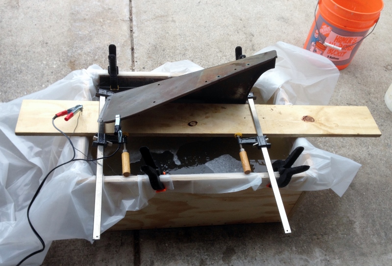

60 lbs of plate steel = $20. the piece on the left side is 1/4" and 4' long, the two stubs are 1/2" each.
[ATTACH]24206[/ATTACH]

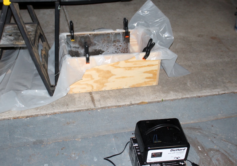

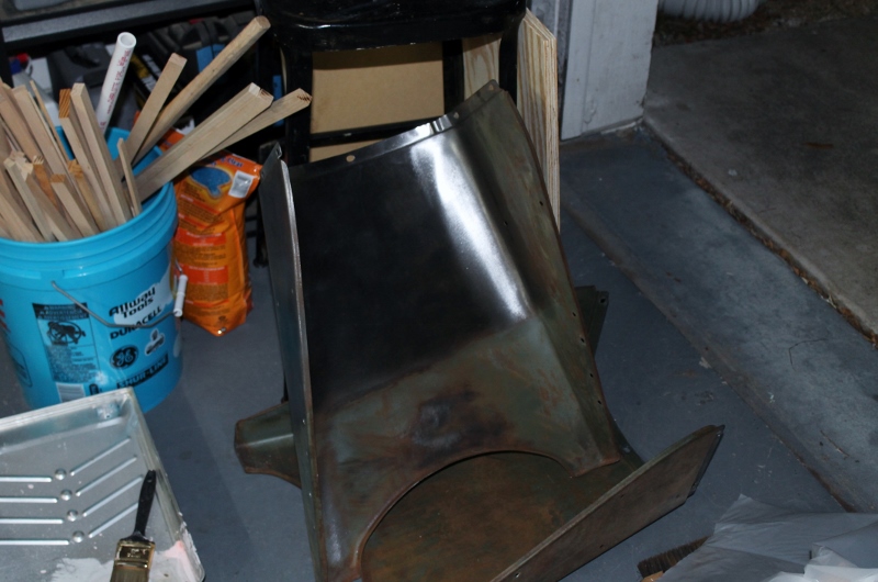

Bath box for the legs that I built after my big plastic bin sprung a leak. If I'd had a brain I could have probably just put that plastic tarp in the bucket but it didn't occur to me. You can see the 4' piece I cut down to 2' so I could bracket the pieces on either side. Got a new angle grinder out of it!
[ATTACH]24216[/ATTACH]

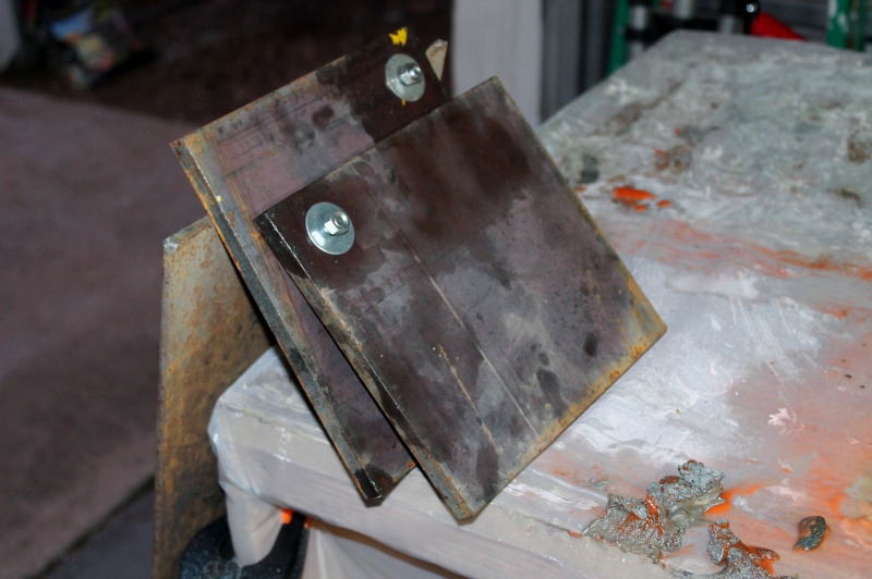

Cleaning up a leg with Jonathan. We were using rough nylon wheels and this was after the plastic bin failed. I was frustrated and figured I'd just do this for the whole thing but changed my mind shortly thereafter.
[ATTACH]24211[/ATTACH]
The silver is what Jonathan got done. The electrolysis before bin failure is responsible for most of that and the demarcation/water line is what sold me on building a better box to use.
[ATTACH]24212[/ATTACH]
Leg cooking sideways. I need to get a picture of what they look like now with all the lines crisscrossing. Not as pretty as the previous pic with the flash rust though.
[ATTACH]24208[/ATTACH]

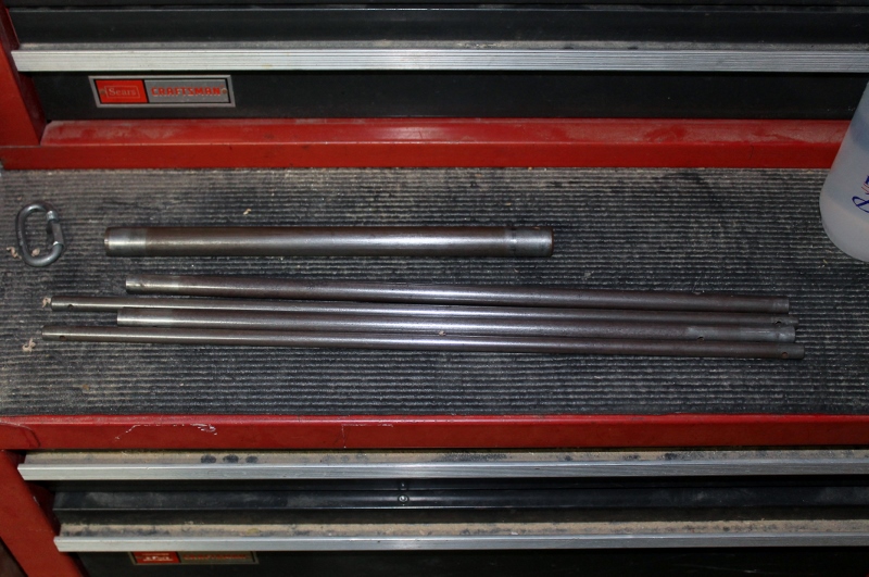

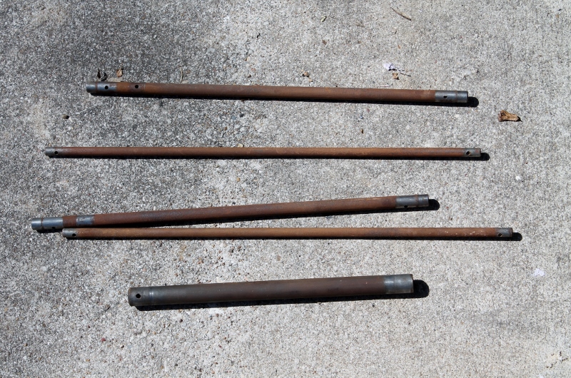

Caster rods and pivot pins before.
[ATTACH]24209[/ATTACH]
Caster rods and pivot pins after.
[ATTACH]24210[/ATTACH]
