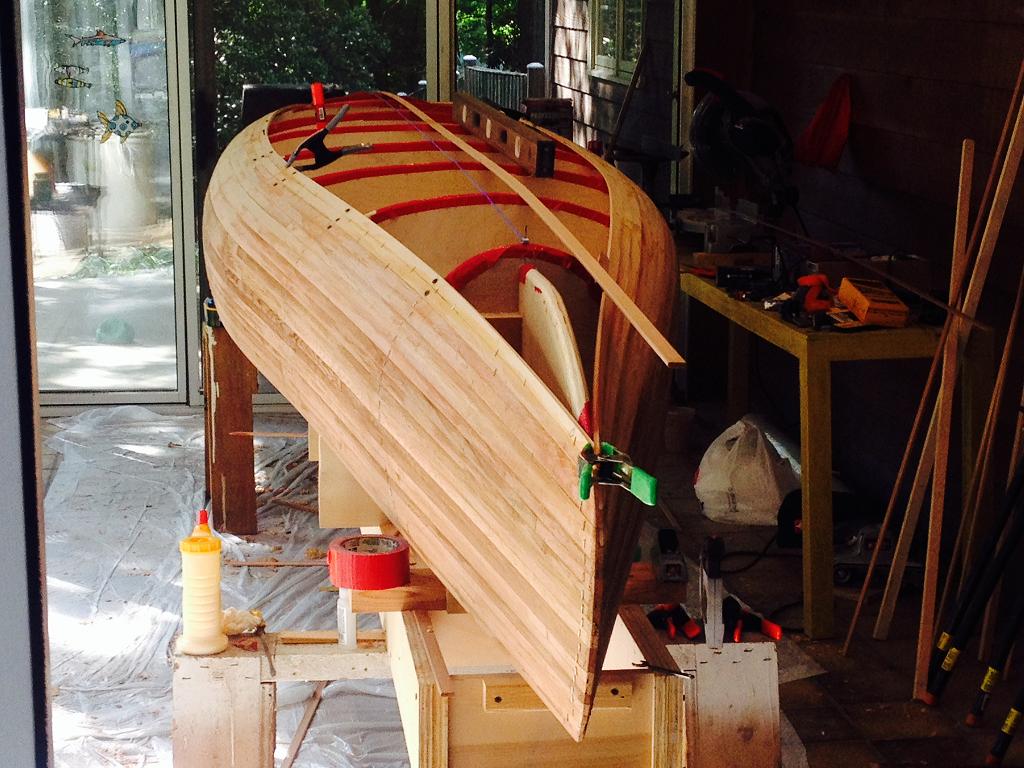

Here's where it gets tricky. Strips bend vertical at bow and stern, and almost horizontal at the middle.
[ATTACH]25900[/ATTACH]
shipwright
Posts: 1165
Post by shipwright »
The problem is caused by something called "spiling". It is the tendency of a plank or in your case a strip to go up or down at one end when twisted. Spiling is also the verb used to describe taking the shape of a plank from the work so that it can be cut in a way that will make it lay in smoothly.
...... I know, I know, easy for me to say. You can't force this. It will get worse.
If you lay a flat batten (use a piece of planking) on the hull even with the top of your last piece, you will find that it likely won't follow it all the way without "cupping" away from the skin. What you need to do is mark a line with the batten flat on the existing planking and touching the edge of the top plank as much as possible and then cut the planking back to that "fair" line. then you can proceed and subsequent planks should line up better.
Alternatively you can fill in with tapered pieces to achieve the line that the batten shows.
Sorry if this doesn't seem to make sense. PM me if you don't get it. Planking one of these shouldn't be that hard but then I don't know the design. :-)

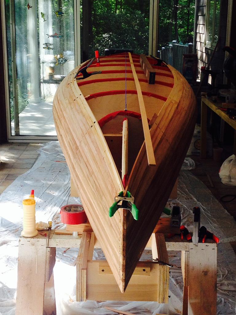

A little more progress after consultation with Shipwright.
[ATTACH]25932[/ATTACH]
[ATTACH]25933[/ATTACH]
