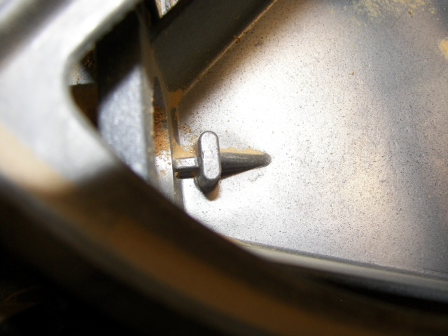

I could allow the eccentric to insert all the way to the stop but then I would have to adjust the band saw height by changing the level of insertion on the lower tubes. I don't want to do that because I would then have to mess with height adjustment every time I mounted/remounted the bandsaw. This way, the adjustment is made with the eccentric tubes inserted all the way to the offset in the Mark V and I adjust for penetration into the band saw. I can not mount/remount the band saw with no height adjustment being necessary.cubcadet149 wrote:I have noticed this mechanical stop inside the bandsaw. I think it is interesting that the correct length mounting tubes (yours) do not go all the way to the stop. I would think it would be desirable to have the mounting tubes go all the way to this stop because they would also be going through the second set of bored out mounting tabs/bosses inside the cast housing. This would make the bandsaw mounting more rigid and less likely to have the casting break at the bottom.

FWIW, my manual says to raise the bandsaw on the tubes(resting firmly on the spt mount casting) to vertically align the shafts.
In my case that lowers the tubes slightly below the stop, but not far enough to exit the upper bore.
Therefore the set screws 'support' all the weight.
I think shim washers would be better to take the load.

You can see in my second photo that the gap is significant. About a 1/4" I would guess. Not exact a shim washer. I absolutely agree that not relying on the set screws to hold that weight would be better and having the tubes extend up into the upper bore would too.JPG wrote:FWIW, my manual says to raise the bandsaw on the tubes(resting firmly on the spt mount casting) to vertically align the shafts.
My concern, if the tubes were extended up til they contact the mechanical stop what mechanical support is lost on the lower end of the tubes. My band saw is not exactly vertically stable as it is. Raising the eccentrics in the lower bores would make it even less stable (I think).

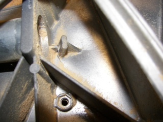

Be careful with the posts when inserting them into the bandsaw. As you can see, the previous owner of mine was not... Dimpled the casting thru the back...
