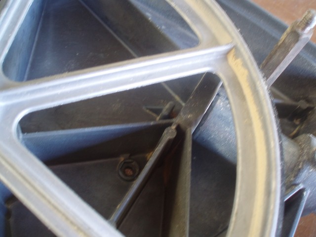

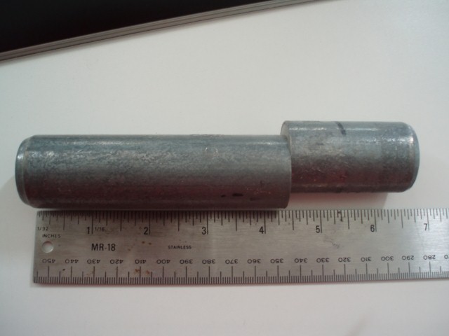

Re: Bandsaw Mounting Tube Question
I hope this answers your question. The second image tells the rest of the story. There is a mechanical stop in the bandsaw that limits the length of the eccentric tubes. After all these many years, I did not know that that mechanical stop existed.cubcadet149 wrote:I will have to take a picture when I am home later tonight. No, the power connector hubs do not align. And I do not have the Power Station. I am hoping someone can confirm the length of the mounting tubes so I can order the correct ones if mine turn out to be wrong. Shopsmith customer service would not give out this info through email, and I don't have a job that allows me to be on the phone on hold all day. The mounting tubes that the manual says I should have are part number 5137779. Can someone measure theirs and let me know? Thanks!
Craigslist purchases always keep life interesting!
- Bandsaw and Power Station (Small).jpg (49.92 KiB) Viewed 1858 times
- Bandsaw and Power Station 004 (Small).jpg (66.48 KiB) Viewed 1854 times

Yes, it does. Thanks, Dusty! The long ones I have must be for a different special purpose tool. Any ideas? I will order the right ones tonight.

I have noticed this mechanical stop inside the bandsaw. I think it is interesting that the correct length mounting tubes (yours) do not go all the way to the stop. I would think it would be desirable to have the mounting tubes go all the way to this stop because they would also be going through the second set of bored out mounting tabs/bosses inside the cast housing. This would make the bandsaw mounting more rigid and less likely to have the casting break at the bottom.
