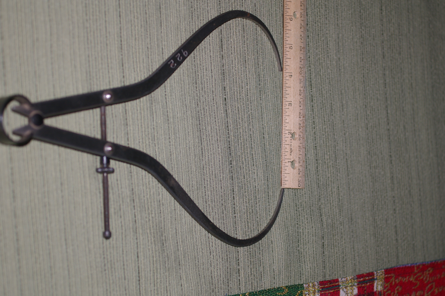

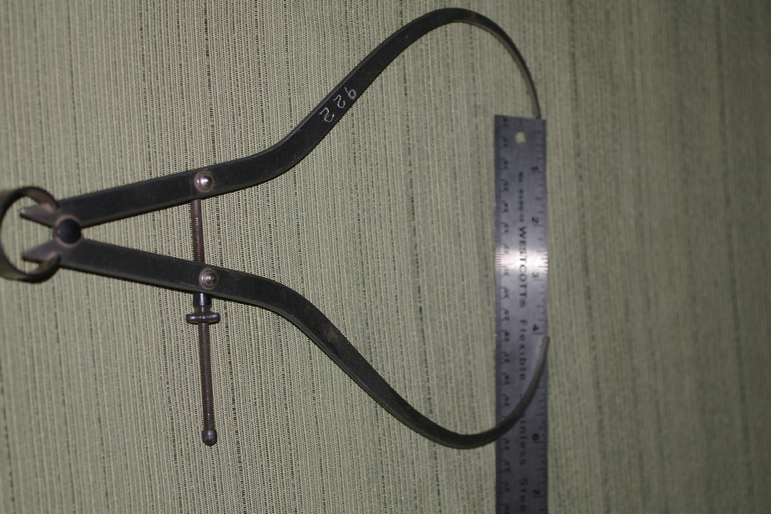

The wheels measure 4 1/4" O.D. Made of urethane as near as I can tell.

dgreen810 wrote:JPG
Don G
They do not appear to be that large in your pix????
I am having second thoughts re small od anyway. Stem length may be a factor.

I got a little "Sloppy", I just love that word, they measure 4 1/16"
