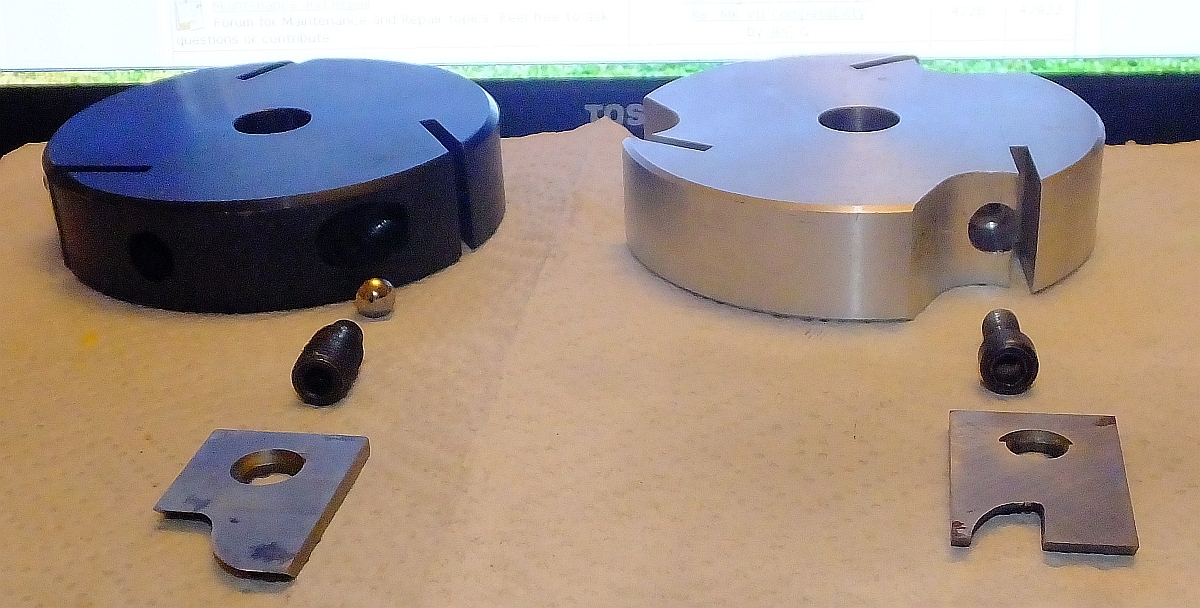

Based on those photos I'd be hesitant to switch the knives between these two heads. The knife from the Shopsmith head shows a pronounced ball-shaped depression which makes sense since that head uses a ball to center and capture the knife blade. The older Magna head blade has not nearly as pronounced a depression, which makes sense if as JPG says the Magna head used a set screw directly on the blade.

Early aluminum and steel made until recently. The aluminum one is I think the same as the magna one in Ibskot's post above. <<<<<< NOPE!!! See below.

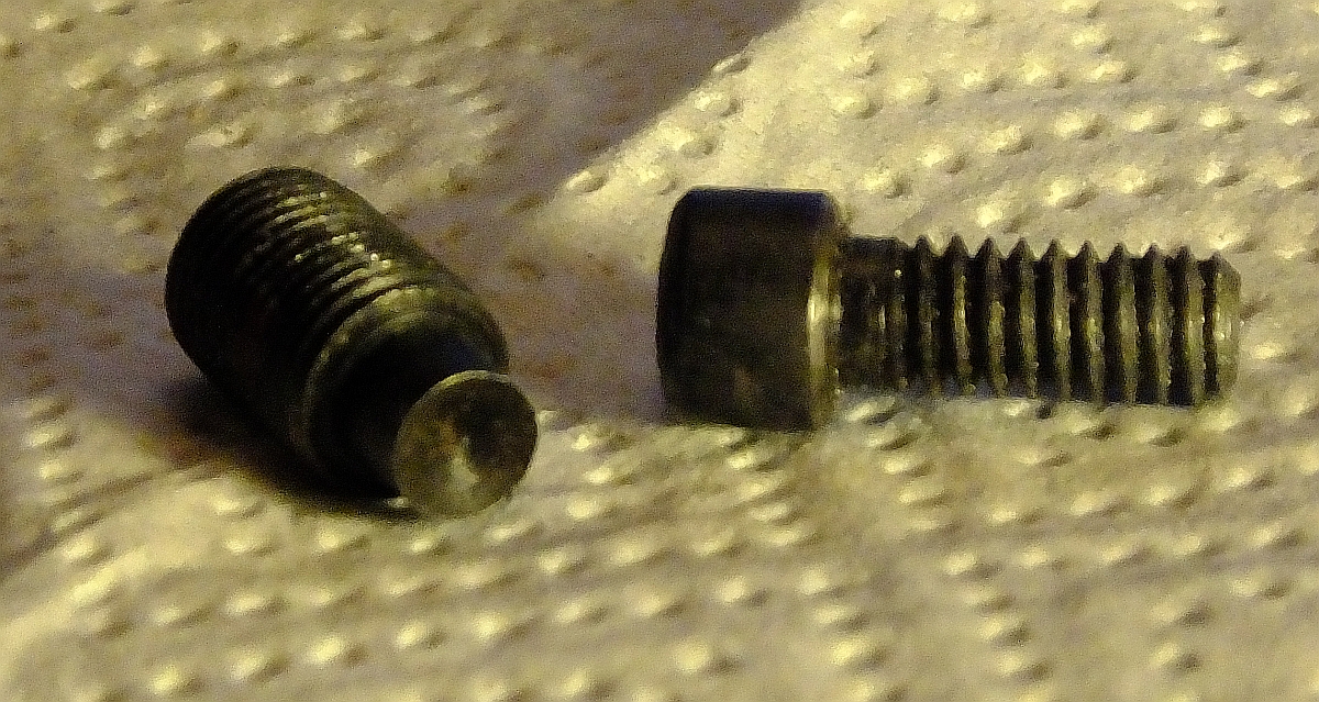

Knife retaining screws etc. The ss version has the special cupped screw that mates with the ball bearing.
The aluminum one also has a special screw. The under side on the cap screw head is beveled, not square.
The earlier post by Ibskot shows better the 'notch' that the cap screw engages to secure the knife.
I think either knife version will work with either arbor version. They both locate the knives securely in the bottom of the arbor slot. The bevel on the oldest version screw does appear to mate with the beveled hole in the 'new(not newest)' version knife.
One detail, the aluminum arbor centers the knives on the arbor, but the newer(not the newest/current) one off sets them slightly.
The knives are 1/8" thick(+-).
EDIT - Ibskot's 'Magna' version is different from the alumunum one.

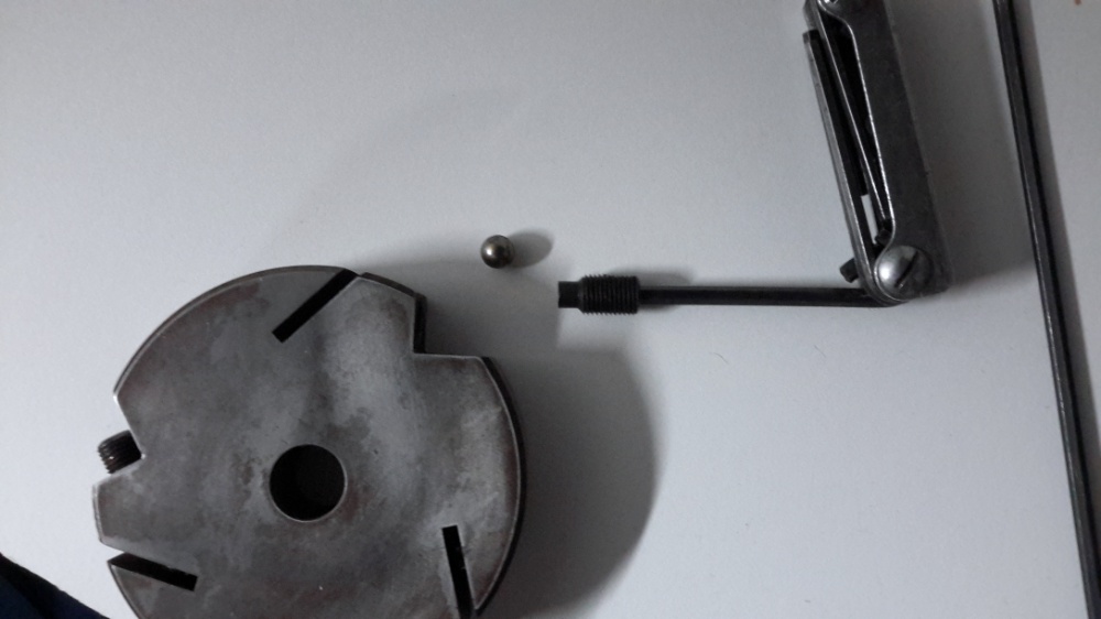

Re: A tale of two molders
For your perusal...
- IMG_20150803_233025.jpg (110.62 KiB) Viewed 3568 times

So, there be 4 versions(at least).
