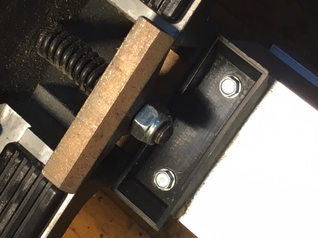

Here is how I solved the plastic piece from falling off my fence. I put in two self tapping screws, never had a problem since.
Re: 520 Rip Scale Mod
Now that is really remarkable. A very clever fix along with a photograph.
How much clearance is there, inside the fence, for the screws.
If mine comes off again, I'll incorporate screws but not the plastic marker.

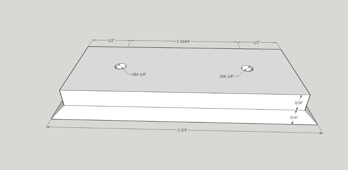

I'll make one of these using aluminum.
You know I think you might have posted this solution before but without a picture? Anyway that sounds like the way to go when mine falls off. I guess I could just go ahead and do it now but hey why do something when you can put it off for a while......... Yea I'll wait until I'm in the middle of a major project then have it come off and delay my efforts until I get it stuck back on, good to have a plan right?
Ed in Tampa wrote:Here is how I solved the plastic piece from falling off my fence. I put in two self tapping screws, never had a problem since.

Places like http://www.shapeways.com/ can print a part like this on demand, its a perfect opportunity for 3d printing if you have access.
