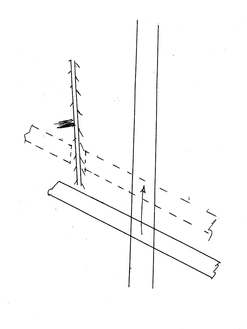

So ya got something more accurate than 0.5 degree to set it with? Starrett not allowed! :D
As for the miter slot/blade ?, the miter gauge face sets the angle and the miter bar sets the direction. The blade front sets the point of cutting. Any miter slot/blade deviation will result in the workpiece either drifting towards or away from the plate of the saw behind the teeth. A minimal amount of concavity would also result(assuming TS - I like BS better).
Now about that 0.5° 'error'. Over a 1" width, that deviation results in a 0.009" error. Significant? In steel maybe. Wood? I donno!

Second question is that if the miter slots on the Shopsmith are not exactly parallel to the saw blade, will this change the actual angle of the cut? From what I get from the video the angle of the miter gauge face is set in reference to the miter gauge bar. So if the table is off slightly it will alter the overall angle of the cut. Yes? or No?

I agree the angle error will be accumulative and the miter bar to miter gauge face are therefore critical, but the question I was trying to answer was the importance of miter slot to blade error.
Not terribly obvious in this sketch, but the blade is clearly not parallel to the slot, but the cut line is parallel to the slot.
MITER SLOT - BLADE ANGLE ERROR.jpg (73.31 KiB) Viewed 9455 times
