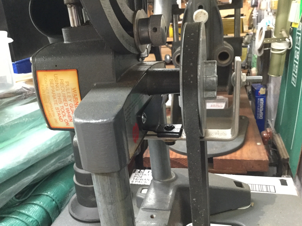

ppolstra wrote: I recently inherited a 1976 ShopSmith Mark V 500 from my grandfather. He passed away 22 years ago and my father inherited the ShopSmith at that time. I was essentially abused and neglected until his death last fall. My brother packed up the ShopSmith and brought it to me mostly disassembled. I have finished rebuilding the headstock and removing the rust and lubricating everything (quill was locked up when I got it as was the sheave on the motor). I have gone through the many boxes of parts and have identified everything except what is in this picture. Looking for a little help. It is possible that some of these parts have nothing to do with the ShopSmith.
Thanks,
Phil

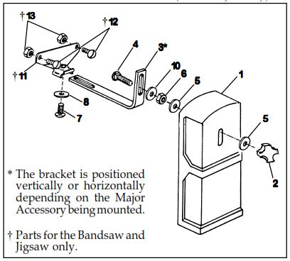

The black triangular bracket at the lower left of your photo looks like SS part number 504083. I knew it looked familiar, but it took a quick search of my shop to pinpoint it. It's item #11 in the pulley guard kit (505862) for Power Stands and such.
The photos below show it on my old-style jigsaw and Power Stand. From the manual, it seems that part wasn't needed for all of the SS special-purpose tools, so it's probably safe to assume that yours is an orphan.
Guard off.JPG (673.56 KiB) Viewed 1809 times
Guard on.JPG (636.24 KiB) Viewed 1809 times
Thanks for the pictures. This actually makes sense to me as my grandfather made his own power stand that I have a jigsaw mounted on. Looks like he bought this kit with the covers, but didn't need this part for his custom stand.
