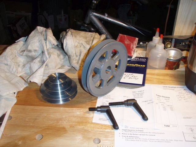

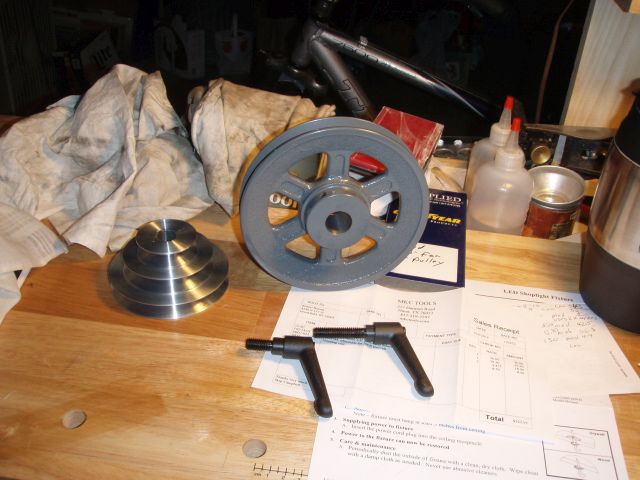

The Post Person Rang Twice today. Skips stuff got here, nice, since no mail on Monday. I dont know if he painted up the pulley but it is one fine looking and balanced cast iron 5.5" pulley.
Of course his other ones are just as beautiful machined Aluminum.
Pics are getting much easier, I got that down pat.

I dont have a small weight scale, but the cast iron pulley must weigh about 4-5lbs, that will be some nice inertial. Like cast iron band saw wheels. In high school shop we had a 24-30" BS, I think a Walker Turner, all cast iron everything. No bogging that thing down!!!!
