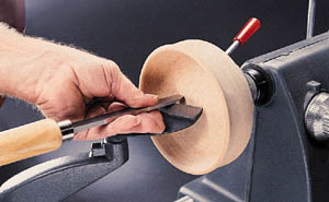

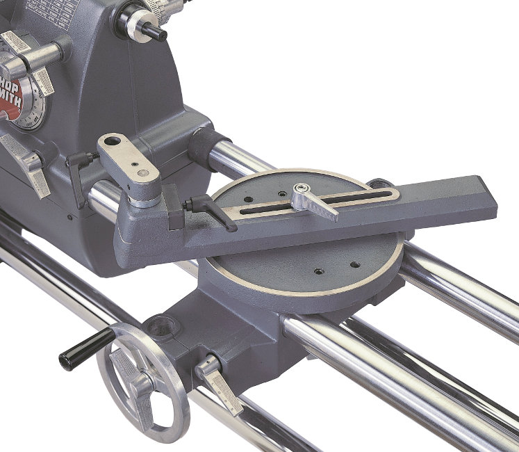

Have you thought of the 555811 Universal Lathe Tool Rest System? I know it is $220 but it does get you into the end of and bottom of the bowl.
A picture of your setup would be very helpful in understanding the issues better for most of us I suspect.
Also you said you have the "S" tool rest. If you bought the Kit opposed to the single tool rest you also have the 4" and the 90 degree, each of which is available separately
The 555314 4-inch Specialty Lathe Tool Rest is about $25 and can be cut down even smaller if you need.
4 Inch Lathe Tool Rest.jpg (16.52 KiB) Viewed 8481 times
Everett
universal tool rest.jpg (103.02 KiB) Viewed 8482 times

I don't have a bowl gouge and a more massive tool would help but I don't think it would solve the whole problem. Shopsmith's universal tool holder would solve my problem but seems to expensive. I am very much aware of using a chisel protruding to far from the tool rest and am trying to avoid that as much as I can. I am presently working on a support that is parallel to the bottom of the bowl that should solve my problem. I am using pieces form my metal scrap bin. It will probably look ugly but it will be solid and should work well. I will post some pictures when I get it done. I can always buy the universal tool rest if my idea does not work. Thanks for the response I can use all the help I can get.
Posts: 3815
Re: Lathe Problems
lalkie01 wrote:I don't have a bowl gouge and a more massive tool would help but I don't think it would solve the whole problem. Shopsmith's universal tool holder would solve my problem but seems to expensive. I am very much aware of using a chisel protruding to far from the tool rest and am trying to avoid that as much as I can. I am presently workiung on a support that is parallel to the bottom of the bowl that should solve my problem. I am using pieces form my metal scrap bin. It will probably look ugly but it will be solid and should work well. I will post some pictures when I get it done. I can always buy the universal tool rest if my idea does not work. Thanks for the response I can use all the help I can get.
As luck would have it, Shopsmith just announced a special on the Universal tool rest, along with some other goodies. The discount is enough to significantly mitigate the wallet pain. I'll be placing my own order tomorrow.
http://www.shopsmith.com/ownersite/spec ... pn=YWUTQQY
I have a nice 520, but I'm actually hoping to figure out a clean way to adapt the UTR to my 10ER, which is currently awaiting light restoration for dedicated-lathe duty. On a stand that elevates it to a comfortable height for my own long and once-lanky bones. And with those massive old way tubes adding even more weight and stiffness. :)
