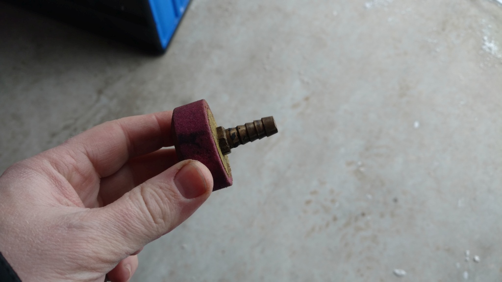

So I had some extras in the drawer that I couldn't figure out what they used them for or how they mounted. Some of this included grinding wheels that didn't fit the arbors, etc. One of the things hit me when I saw a barbed air hose fitting with male pipe thread that had marks on the barbs from the drill chuck. Would you call this stupidity, or ingenuity? Lol. My grandpa would have done this very same thing on the farm.
