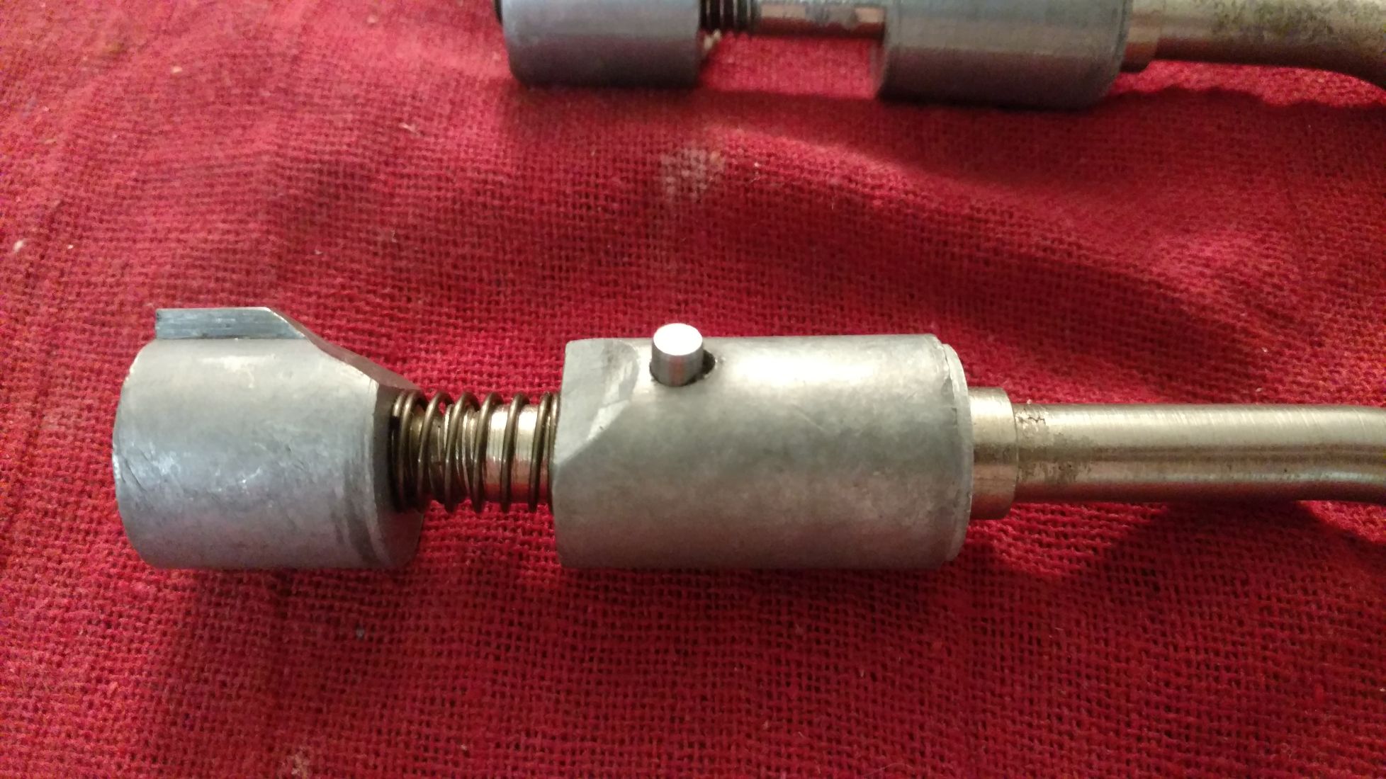

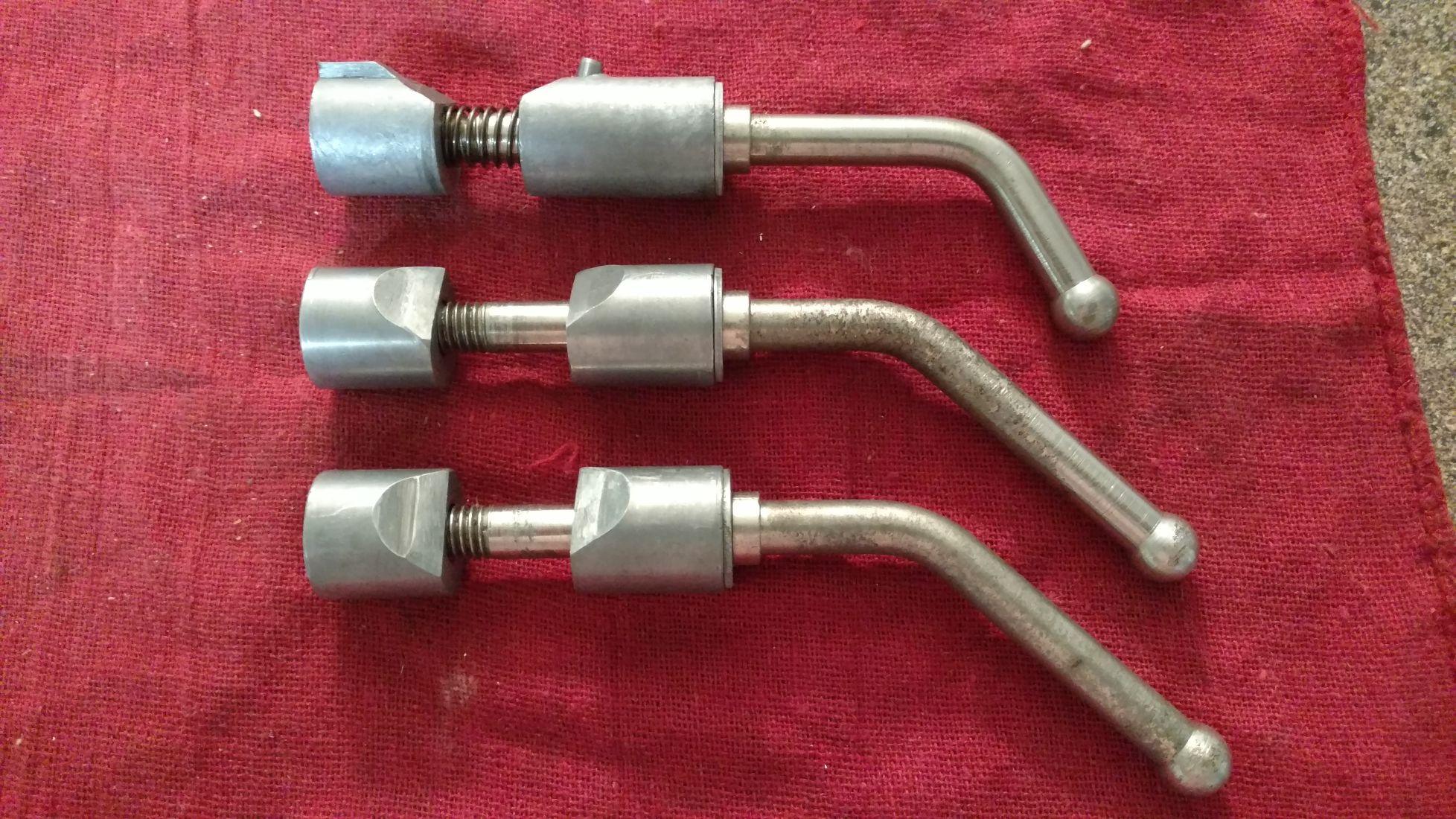

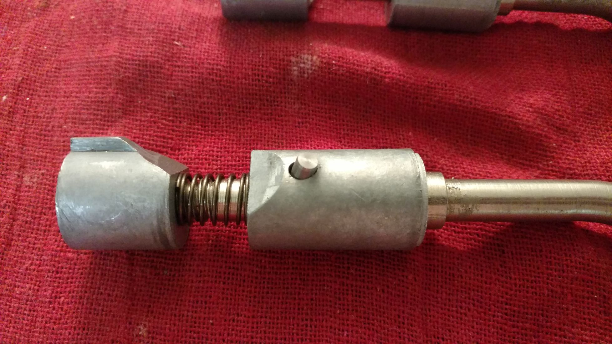

Here are my wedge lock sets from the 10ER in question.
It is apparent that the inside 1/8" or more of each way tube wedge does not contact the tubes. I'm wondering if it would work to remove these ends of the wedges and place a spring in the middle similar to the spring the quill lock has, and if that would help with part of the issue (the back wedge sticking). Of course I would also have to file or drill out the inside of the back wedge to remove the "threads" that have formed so that the nut is the only part that engages with the bolt threads. The problem does not seem to be with the headstock bore size, as even the ovoid wedges slip right into the bores. I don't think smashing them back to round or removing material from the outside of the wedges will improve anything since that part isn't tight.
Regarding the quill lock, one of my earlier photos in this thread taken from an eBay listing also shows wedges with steel pins driven in. The front quill lock wedge is also much longer than the way tube wedges so I can't see that someone would have taken a wedge from elsewhere and modified it. It seems I've come across a few other pics of wedges with this same type steel pin that would fit into the keyway.
As the last two pics show, the pin appears to be contacting the quill and pressing back into the softer metal. I can rock it back and forth and it slips right out of the deformed hole. I was thinking of drilling a hole the same size further back from the quill and reinserting the pin. The keyway in the headstock is undamaged. However, this quill lock was not inserted when I picked up the machine, but was loose in the "box of parts". So it is possible a previous user left it out because of having an issue with it.

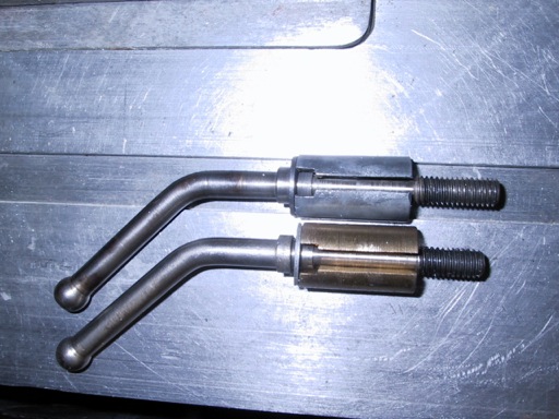

Here's a few photos of the locks that shows the earlier locks including the brass ones.
I cannot fathom how you could not find a brass rod of suitable size and fabricate a set in the shop, especially a machine shop.
As you can tell, the brass inner wedge was threaded opposed to a recessed nut.
They were the same dimensions, so you can measure yours and fabricate a set I feel certain.
I plan to make a set myself, and I will take a piece of hardwood, angle bore a flat hole in the side of it that allows the brass rod to protrude at the angle of the wedge, then I will use the sanding disk to remove the material for the wedge itself. Should be simple enough to do.
My three jaw lathe chuck and drill chuck on arbor / MT2 in tail stock should allow me to both drill and tap the pieces as needed.
I hope the photos help answer your questions.
