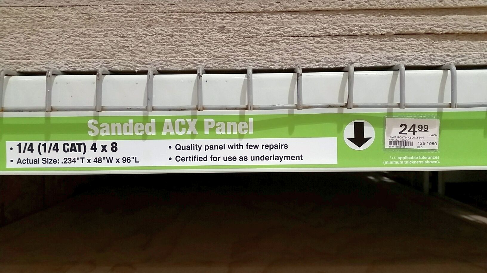

Re: Got a question for my fellow woodworkers
dusty wrote:OKAY, Ed. Now you have me wondering. If you already have this Freud Box Joint Cutter Set, why wasn't it the go to solution?
Does your 1/4" plywood actually measure less than a 1/4"? That was my initial interpretation of the original post.
BTW, thanks for the reminder. I have that same wobble blade but I did not know where it was at. This relocation that I have just been through has caused a lot of things to be hard to find. After reading your post, I went out and tracked down my wobble blade.
Yes the plywood I'm thinking of using is less then 1/4". The sticker from the pile:
And from past experience this number varies depending on the lot.
For those of you decimal challenged folks a true 1/4" should be .250, the .234 is then undersized. And while it would be possible to get by with a standard 1/4" cutter it would be better to cut closer to the real size you need and that is what I'm hoping to do.
