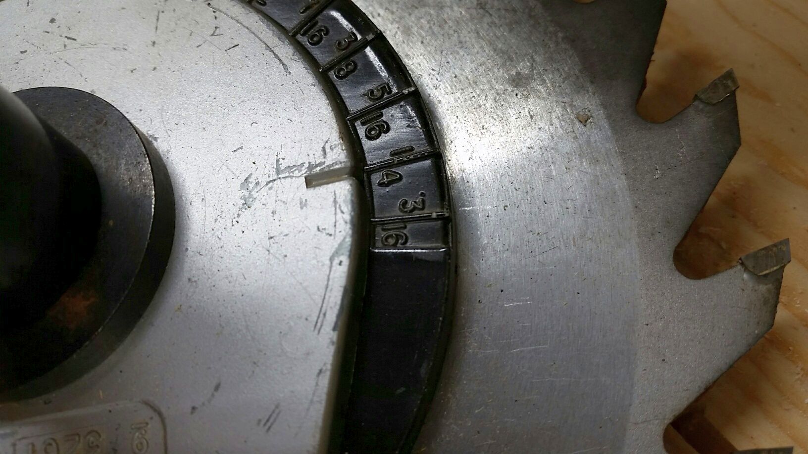

I have two sets of undersized router bits that I use for this purpose, and they work well. How ever I was thinking about not going with the router due to the number of cuts, a table saw would be much faster if you can get by making one cut but if you have to double up then it is more then likely not worth it.
I can see doing some ruff cuts with bent teeth but I think they will tear up the plywood really badly. Besides I don't have any old steel blades they are so 70's and before. It would be interesting to see how much damage that would do but..... I don't want the results to look like a squirrel did the job.
I do have a wobble blade which I can dig out and test to see how narrow it will cut.
It would be nice to have a snug fit so I don't have to mechanically or glue the pieces in place, I want them to pull out for changes in spacing but not come out too easy. A fine line to get the right fit.
Time to check the wobble blade and then let you know the results.
Re: Got a question for my fellow woodworkers
Well look at this:
Problem solved! Thank You!
Didn't even think to check this blade. So add this as a positive for wobble blades.
