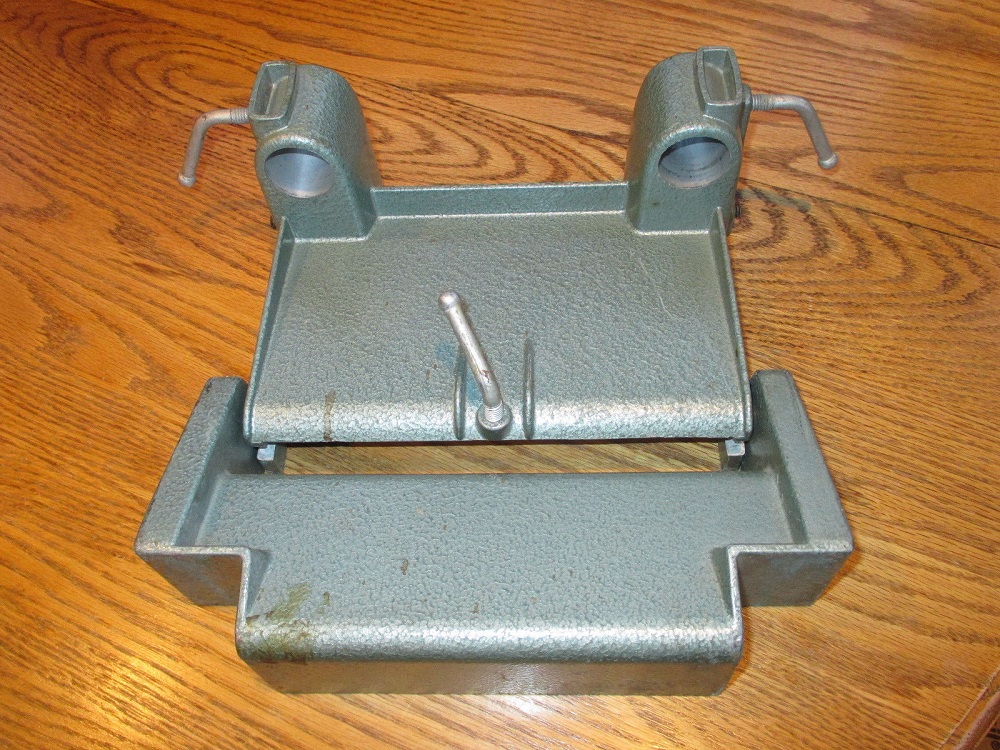

While looking over the Mark 2 I noticed an interesting thing about what is the Headrest/Tie Bar which in the case of the Mark 2 is called Base and Tie. Something about it's design looks familiar.Does the Mark 7 come to mind? It looks like if you change the Base and Arm to the Base and Tie, move the Headrest end in 3-1/2" like the base end and cut off 3-1/2" from the Way Tubes you would have a Double Tilt Mark 2.

Assuming your dimensions are correct, yes. And the lack of pinion gear and rack on the table mounting posts also makes a possible under table rout/shaping, but there is still the speed inadequacy.chapmanruss wrote:While looking over the Mark 2 I noticed an interesting thing about what is the Headrest/Tie Bar which in the case of the Mark 2 is called Base and Tie. Something about it's design looks familiar.Mark 2 Headrest Assembly - Base and Tie r.jpgDoes the Mark 7 come to mind? It looks like if you change the Base and Arm to the Base and Tie, move the Headrest end in 3-1/2" like the base end and cut off 3-1/2" from the Way Tubes you would have a Double Tilt Mark 2.
I do not know if reversing the table places the table cutout(insert hole) correctly.
Yes another precursor of Mark 7 and 5xx stuff.

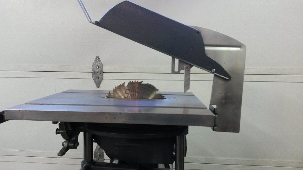

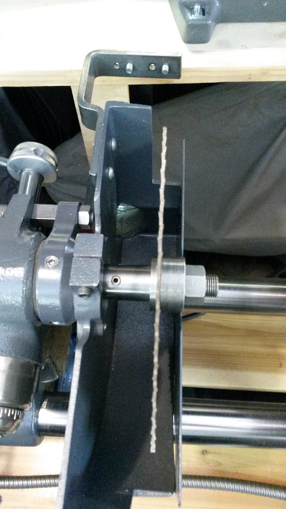

For historical purposes it is nice to have the Model 10 lower blade guard but as a practical part to use, it scores pretty low, just above not having anything there. A better Lower Blade Guard that fits the Model 10's is the one for the Mark 5/V shown below and in my earlier post in this thread. Using the Upper and Lower Guards (505627 & 505628) together reduces alignment time if you keep them attached to each other. I would use the 5/8" Arbor with the machined washer next to the base, then the blade, the wide spacer and lastly the nut (see 2nd pic below). This moves the blade closer to the quill and keeps it from hitting the far side of the lower guard. Although, for safety, I use the later Arbor with the keyed washer instead of the original Model 10 version shown without it. You can use just the Lower Blade Guard 505628 with the Model 10 Upper Guard. Either way you add dust collection to your Model 10. even though the Mark 5/V Guard set was made for a 10" blade stay with the 8" blade since that is what the Model 10 Table was designed to use.

Thanks for posting this. I never would have thought to try that, and I have an old set of guards collecting dust - and not sawdust!chapmanruss wrote:For historical purposes it is nice to have the Model 10 lower blade guard but as a practical part to use, it scores pretty low, just above not having anything there. A better Lower Blade Guard that fits the Model 10's is the one for the Mark 5/V shown below and in my earlier post in this thread. Using the Upper and Lower Guards (505627 & 505628) together reduces alignment time if you keep them attached to each other. I would use the 5/8" Arbor with the machined washer next to the base, then the blade, the wide spacer and lastly the nut (see 2nd pic below). This moves the blade closer to the quill and keeps it from hitting the far side of the lower guard. Although, for safety, I use the later Arbor with the keyed washer instead of the original Model 10 version shown without it. You can use just the Lower Blade Guard 505628 with the Model 10 Upper Guard. Either way you add dust collection to your Model 10. even though the Mark 5/V Guard set was made for a 10" blade stay with the 8" blade since that is what the Model 10 Table was designed to use.$matches[2]505628-10ER.jpg
