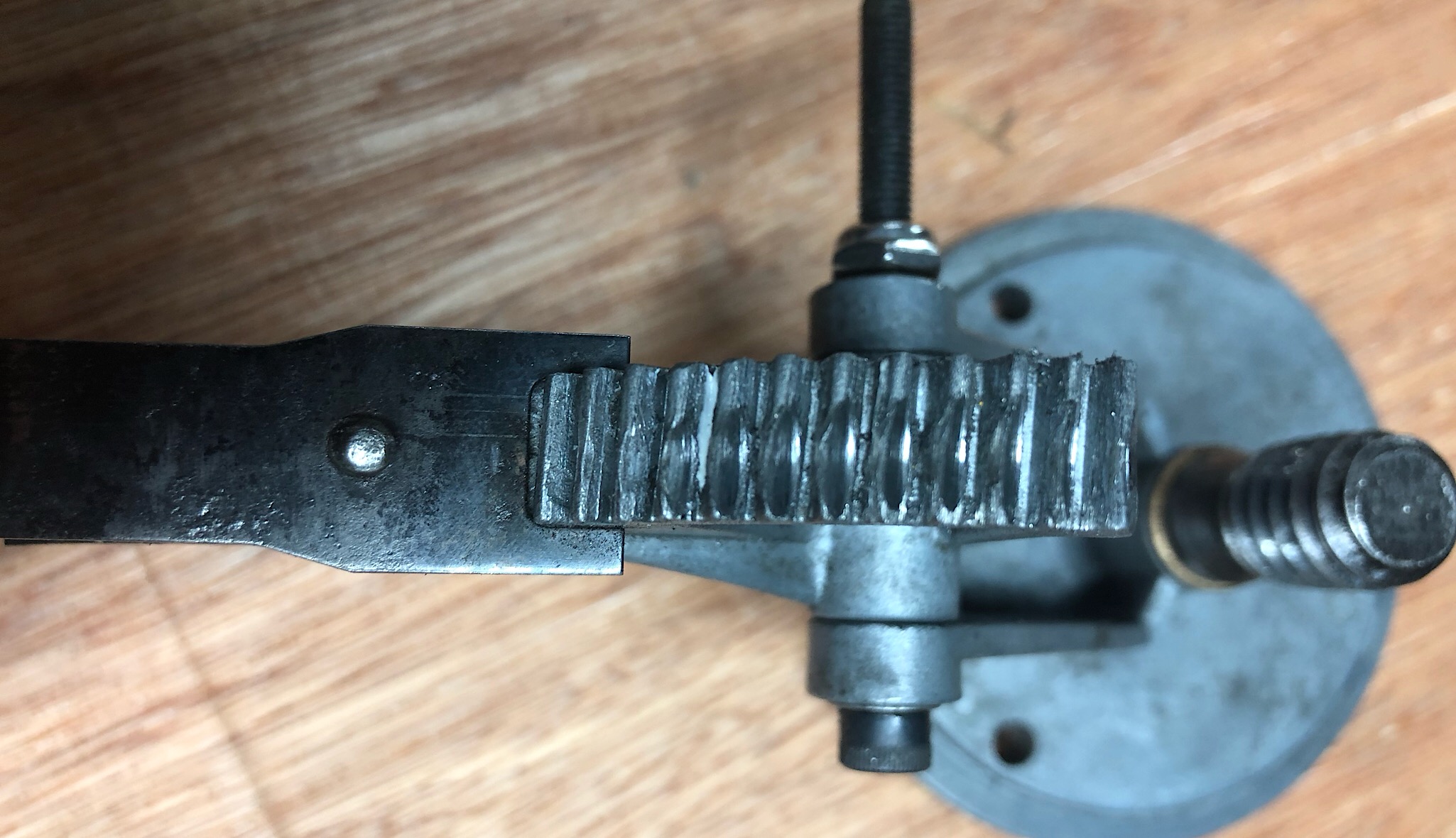

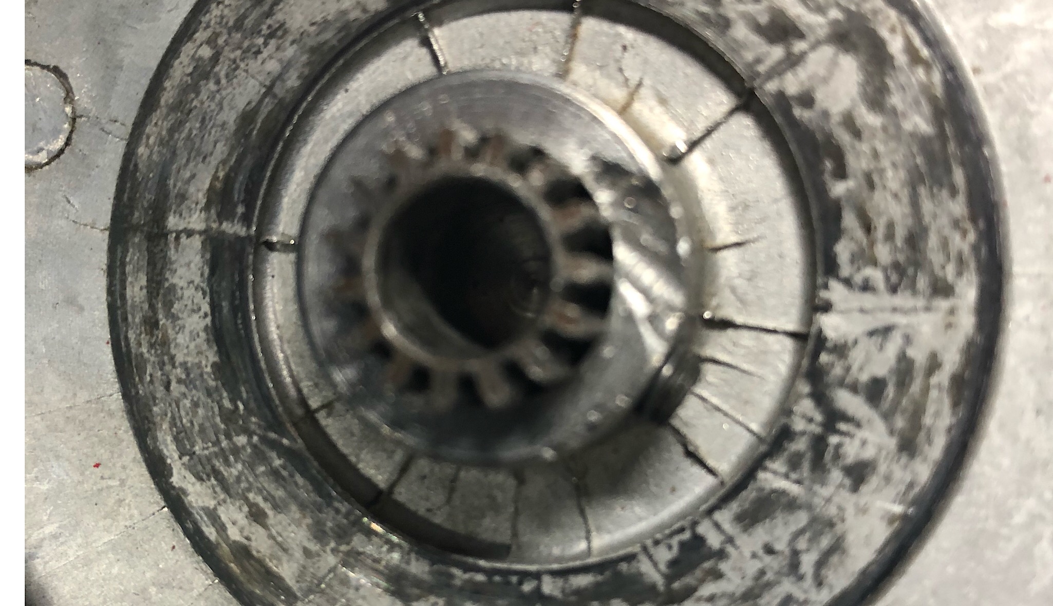

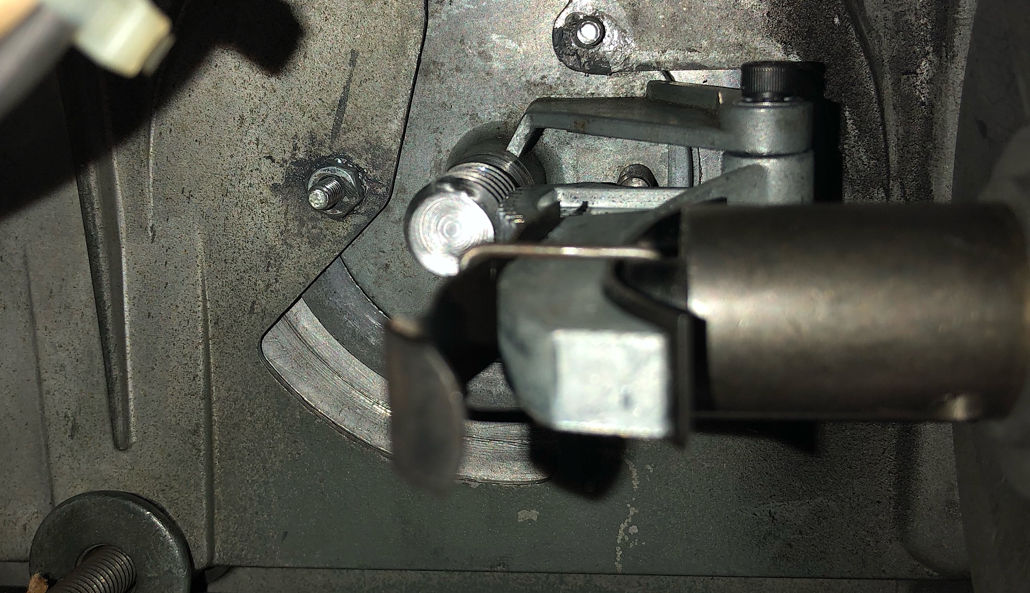

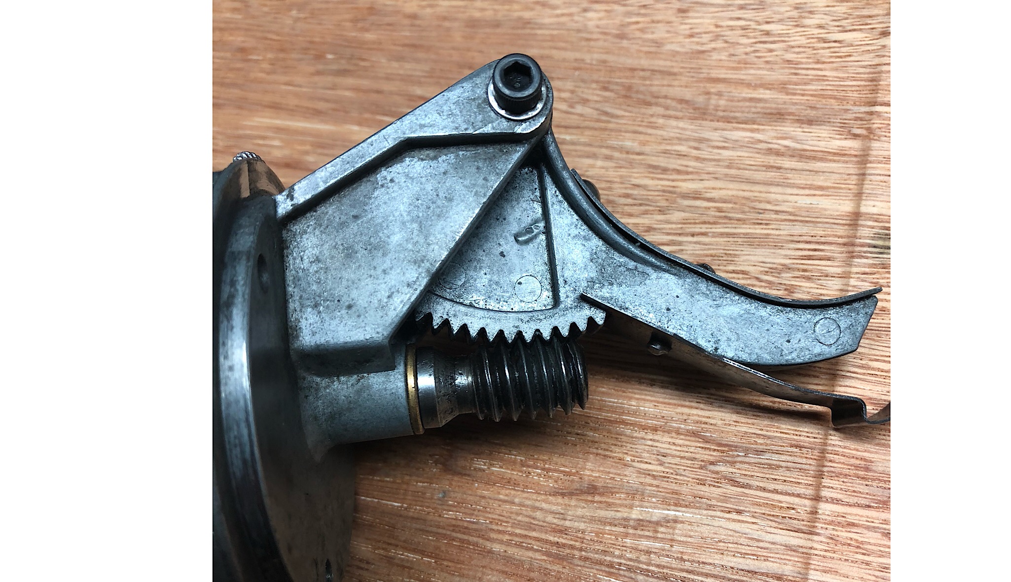

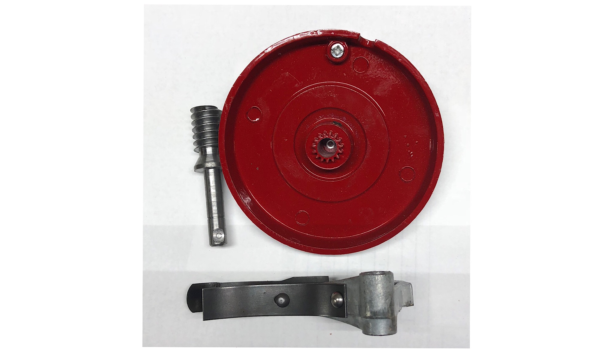

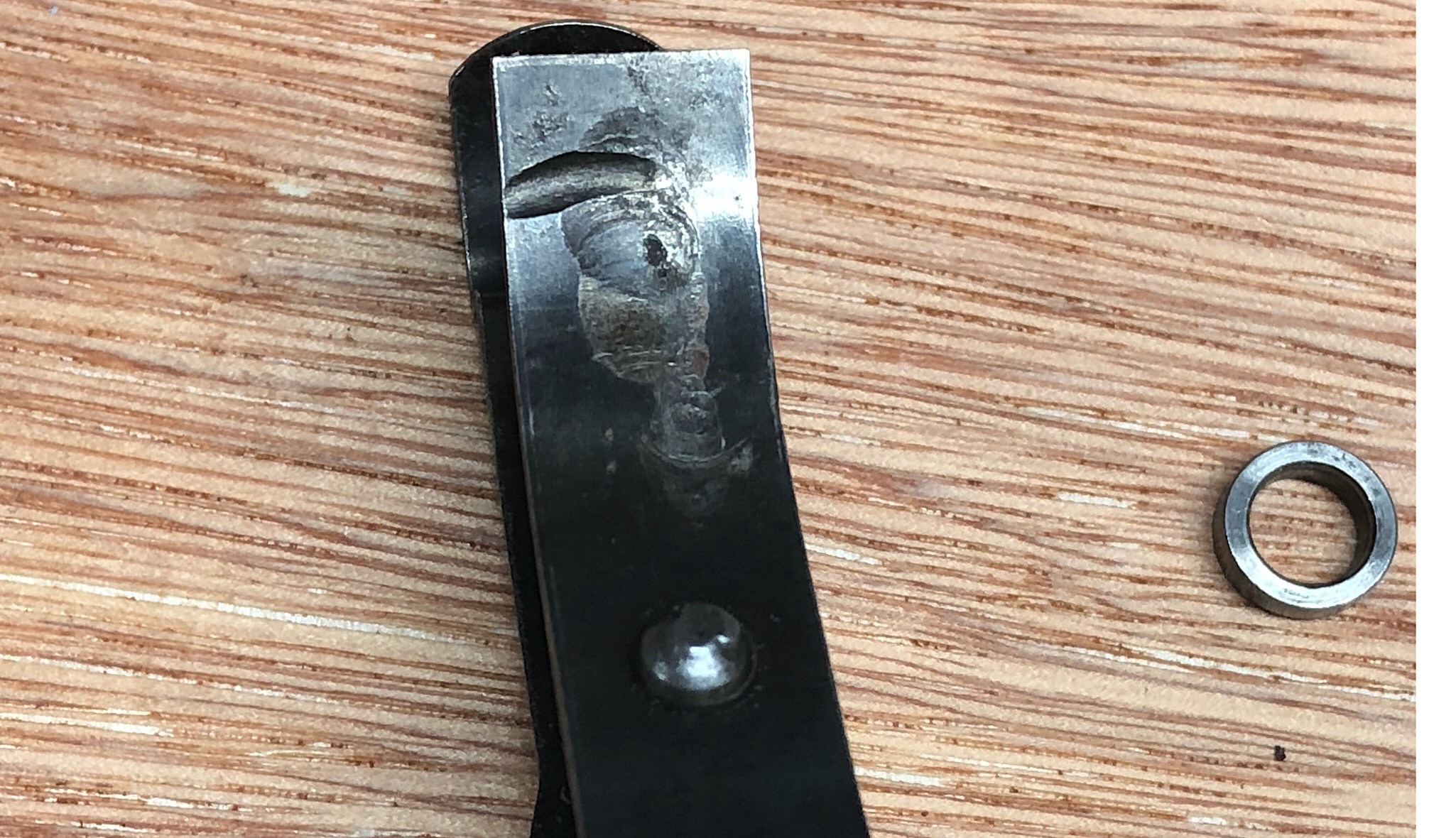

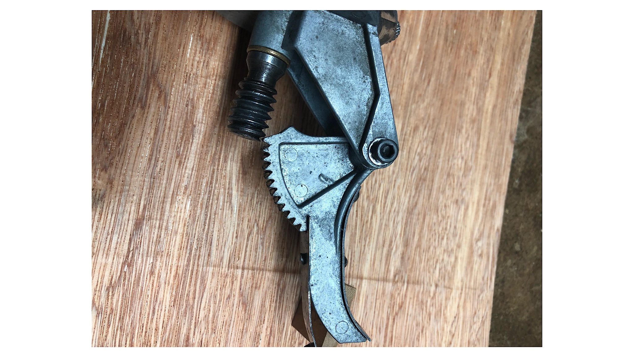

These pics show the quadrant.
Do these provide any greater insight as to why turning the speed control handle is so tough and why I can’t get lower speeds?
The last pic is the back of my Speed Control Handle.

Well we now know why the knob was crooked. It appears the set screw causing the knob to get cocked on the shaft.
The quadrant gear is causing the bind at "F" due to the wear on the steel plate on the arm of the quadrant gear. There is a depression worn into the steel plate that the control sheave button is 'dropping' into.
I would get a new quadrant gear from SS. I think the worm gear shaft is salvageable, but you will need to make sure the knob gets aligned to the shaft correctly. The set screw and the shaft are apparently boogered.
I would cut off the excessive bolt length that replaced the tension pin pivot.

Now about the knob. The pic is out of focus, so this may not be accurate. It appears you have a repaired knob since it kooks like the gear has been replaced. Usually that is a good thing assuming the bore for the shaft is correct(it looks worn).
Is the set screw easily going all the way into the bore area and are the threads good on both the screw and the knob?
Does the knob mount correctly(square to the shaft) on the shaft with the shaft out of the speed control?

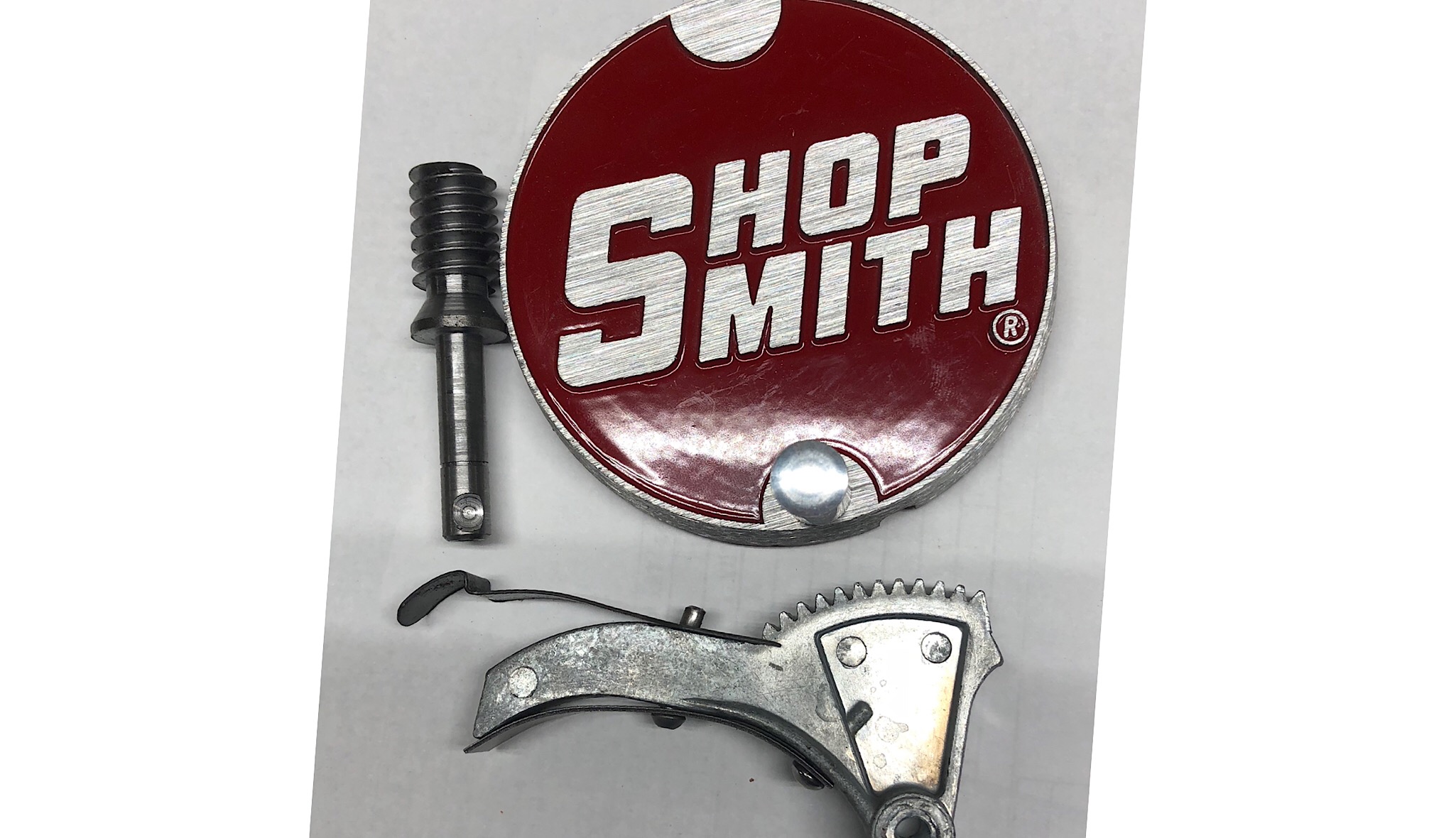

Following your advice I got these:
New stuff looks nice.
I cleaned off any flash, test fitted the pieces, added some white lithium grease, and installed it all.
I manually rotated the system without power using the sanding disk and it bound up at “F”.
D<#%£!

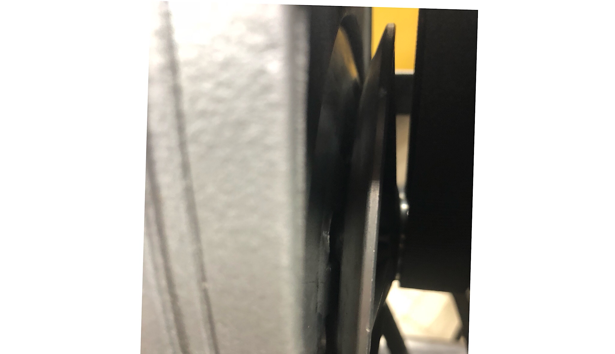

I took off the belt and manually moved the control sheave back and forth. It moved easily. At the position for slow speeds the sheaves looked like this: I’m at a loss.
Any ideas?
D<#%£!
Any ideas?

That pix appears to be the control sheave with the belt NOT on the pulley.
The pulley is fully closed which SHOULD be beyond the "slowest" speed possible.
