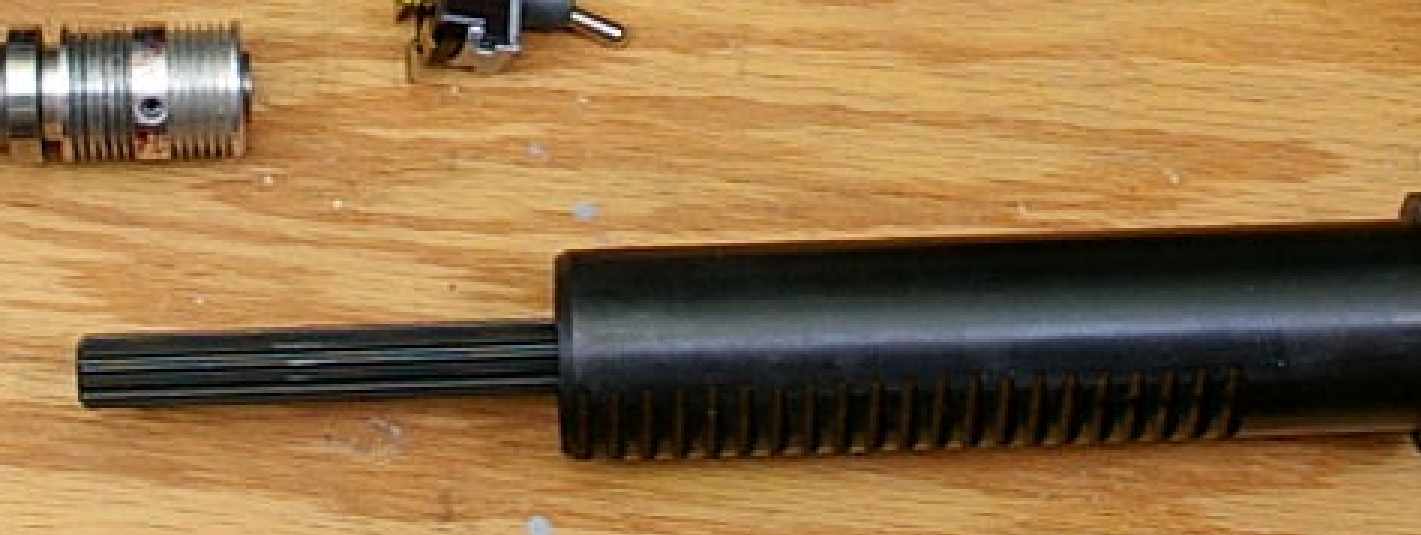

Just a curious anomaly in the upgrade photo.... Zoom the picture to examine the splines on the quill. I have always found it odd they didn't use a photo of the poly-v version of the assembly and actually used an old Gilmer drive quill assembly in the photo for what's in the Power Pro upgrade.

Where is that upgrade photo located? I have not noticed a gilmer quill in any upgrade pix that I have seen.

It is the photo in the second post in this thread.

Since the gilmer quills were not to my knowledge ever black oxidized I also wonder where the one in the picture came from? Is it possible the photo is playing tricks?

JPG wrote:Since the gilmer quills were not to my knowledge ever black oxidized I also wonder where the one in the picture came from? Is it possible the photo is playing tricks?
Yes, that is very "possible" but it is also possible that the quills were at some time black oxidized.

The proliferation of black oxidizing steel parts as rust prevention is a SS Inc. induced procedure. Other than screws etc. Magna et al and Yuba did not do so. I do not think anyone else produced Gilmer quills.
I believe the photo is suspect as to what is pictured.
P.S. Regardless one would think a version specific two bearing quill would have been provided to the photographer.
It sure looks like an early Gilmer when you zoom in.

Sure does.
