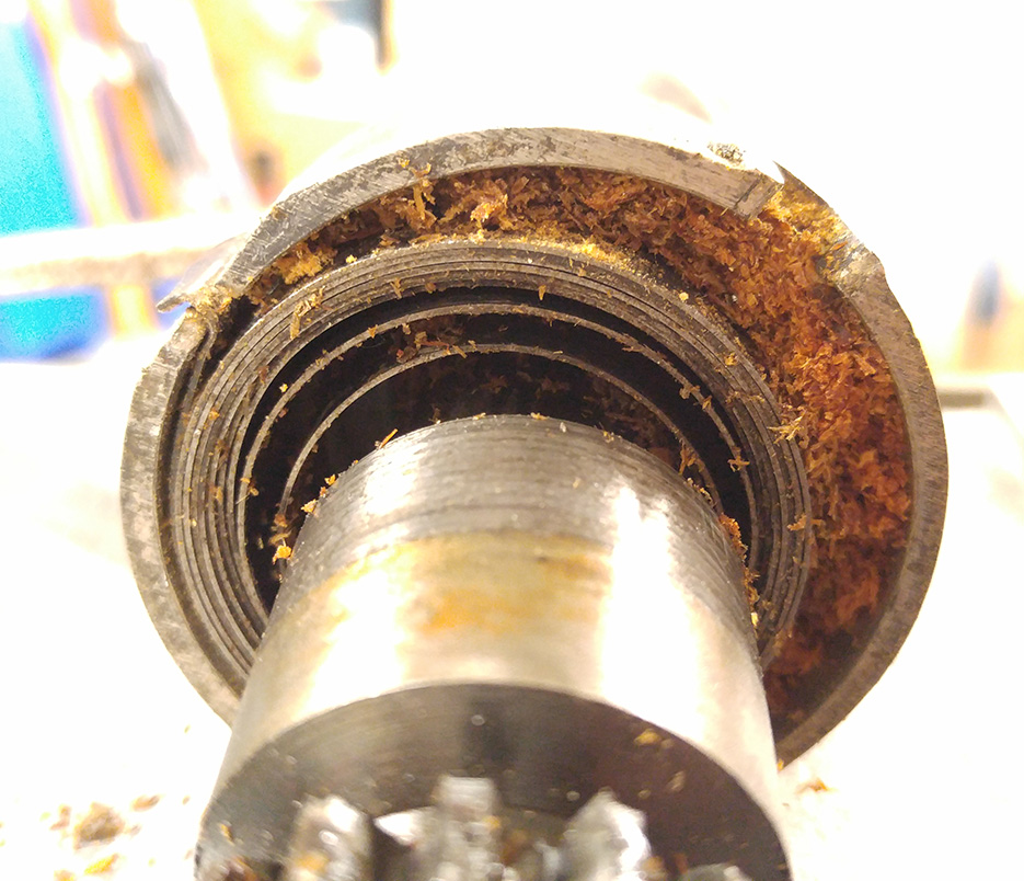

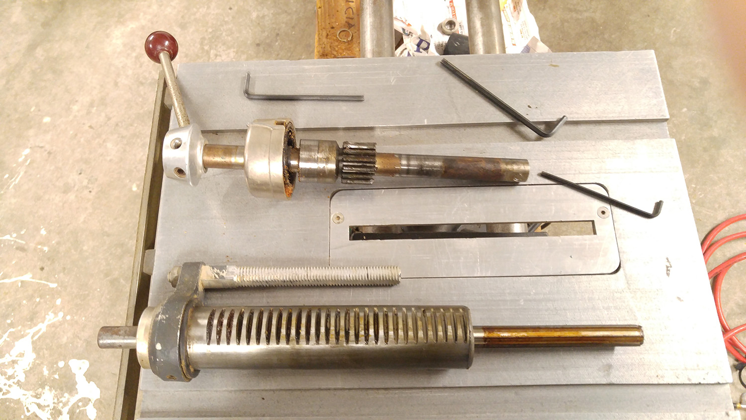

Alrighty then. A little gentle persuasion with a rubber mallet got the shaft moving enough till the burr cleared the collar. Got he pinion shaft out, but then couldn't get the quill out. I had to put the pinion shaft back in and put the handle back on to get the quill moving. It's all out now, and not looking too bad. Mostly just appear to be gummed up with grease. And the spring housing and spring are packed full of saw dust. So I suspect a little cleaning and lubricating will get these moving better.
For lubrication here, do I use machine oil of Johnson's paste wax?
Quill and pinion shaft
Spring
Spring

The grease is probably why it was gummed up. Johnson's paste wax is what you want to use. Absolutely no grease or oil on anything.

Now onto the drive sleeve. Looks like I'm going to need some penetrating oil. I loosened the setscrew, but nothing is moving. All I have at the moment is WD-40, so I suppose I'll give that a try.

The drive sleeve should be a slip fit in the headstock, but when I took mine out I had to put a large wood dowel in from the quill end and tap it out with a hammer. Some one had put a sticky tar like substance on it and that resisted removal. If yours has that as well a bit of heat might help to soften it up.
I believe there is only one set screw, but the bolt that hold the upper pulley guard may also bear on the drive sleeve.

rpd wrote:The drive sleeve should be a slip fit in the headstock, but when I took mine out I had to put a large wood dowel in from the quill end and tap it out with a hammer. Some one had put a sticky tar like substance on it and that resisted removal. If yours has that as well a bit of heat might help to soften it up.
I had the pulley guard bolt pulled out, so that wasn't interfering. I just got it out using a large dowel like you said and some tapping with a rubber mallet. It all appears to have some thick sticky brown grease on it just as my pinion and quill do.
Everything is out now, so I guess it's time to start cleaning it all.
