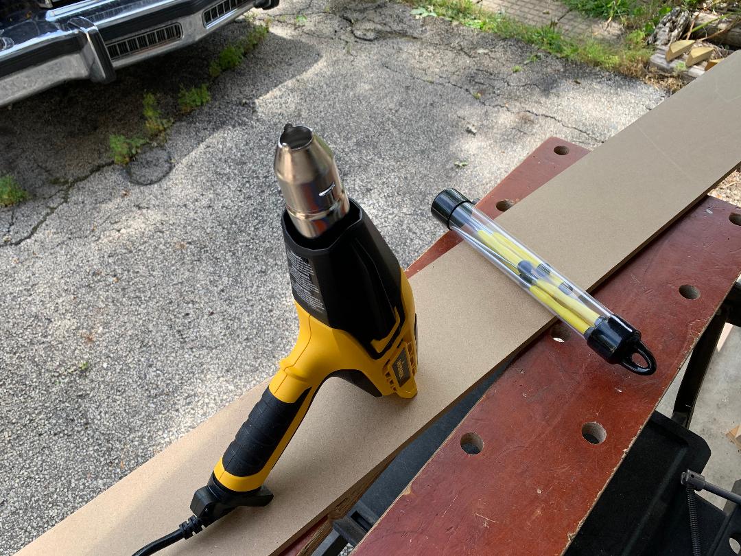

Next I got out my heat gun. At first try I thought it was discoloring the plastic but as it cool that went away. I also go some sag on my first try, you have to keep it rotating like when you blow glass.... Had it set at 600 degrees which is more then it needed I think but it worked. The edge is still not polished but much better then before. I'd say it good enough.

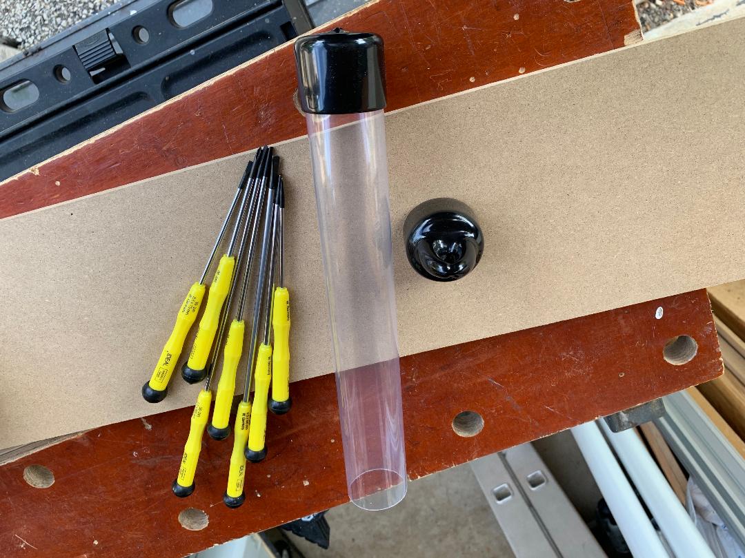

Pictures of the tube ends didn't really work out but I did have a few others that I can share.
Yea all this fuss for such a small thing. Well I do have more tubes and more things that can be put in them so this will be an on going adventure.
