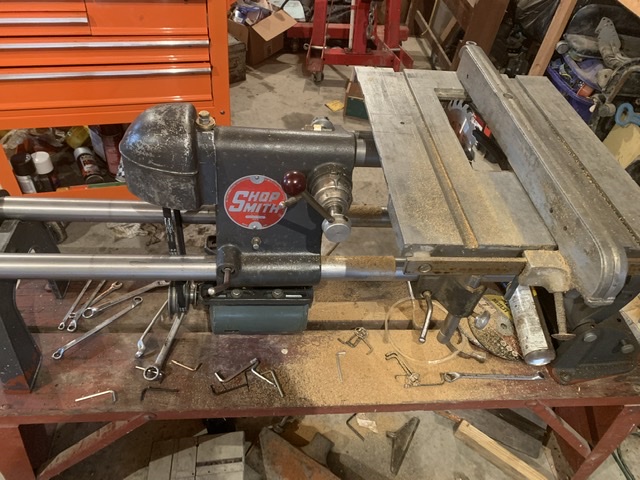

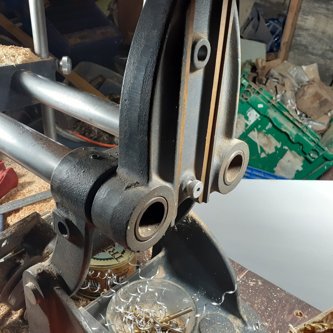

Also, dumb question, but how is the tailstock held onto the way tubes? I can't for the life of me specifically remember taking it off, and I don't see any setscrews on it. You can see in my latest picture that I have it incorrectly installed on the wrong side of the base.
Re: Another 10ER Restoration
The tailstock mounts on the outside end of the way tubes, and there is either a knob (earlier extension table with the shorter bracket), or a bolt (round head, hex socket) similar to the one that holds on the upper belt guard (later extension table with the longer bracket)JNewton wrote:Also, dumb question, but how is the tailstock held onto the way tubes? I can't for the life of me specifically remember taking it off, and I don't see any setscrews on it. You can see in my latest picture that I have it incorrectly installed on the wrong side of the base.
When you are re assembling, before the headstock is on, put the way tubes in vertical mode and adjust them so the ends rest on the pads on the base and they are perpendicular to the bench.

It looks like you are well on your way. The Sanding Disk for your 10ER should look just like the one with the Mark 5 Goldie I posted the picture of. The only difference is the one for the Model 10's has a 3/8" set screw instead of the 5/16" set screw used for Mark 5 accessories attached to the spindle. Accessories that attach to the spindle of the Model 10's used either 1/4" or 3/8" set screws. Those were changed to 5/16" set screws with the introduction of the Mark 5 thereby needing only one tool for changeovers. Your 10ER should have the same bolt (P/N B 2337 Knurled Socket Screw) that Ron showed in his picture to hold the tailstock on. As for hardware most everything that stays together is held together with 3/8" set screws most of which are 1/2" long. There are some other size set screws used also. Below is a PDF listing all the set screws used for the Model 10's and their accessories.
The set screw substitutions I list are for set screws that protrude above the surface of the hole and the shorter ones recommended put them below the surface. Although not original, substituting flat end instead of the standard cup end set screws for accessories that attach to the Quill's Spindle would be desirable to avoid cup indents on the spindle. The Knurled Socket Screw P/N B 2337 for the tailstock and the Knurled Socket Screw P/N A 2333 to hold on the Belt Cover are not on the list above.

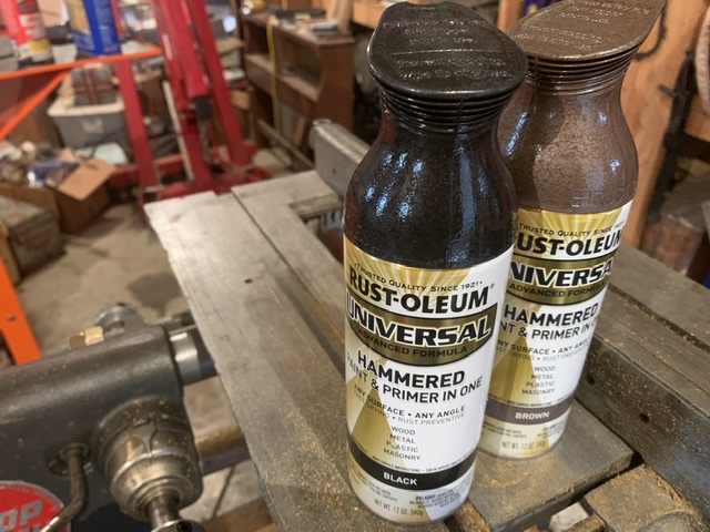

Also, here are the colors I’ve decided to go with. I’m thinking the black for the head and bronze/brown for the periferals, with some black highlights elsewhere. “Custom” but workmanlike is my goal. Nice thing with paint is I can always take another shot at it if dismayed by the outcome.

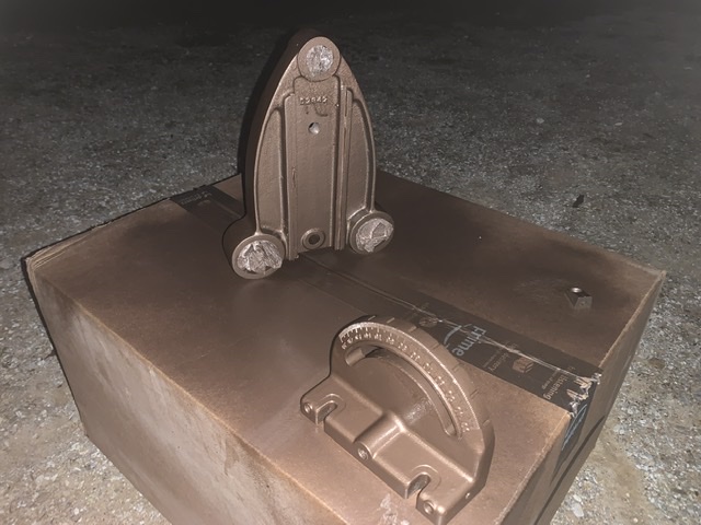

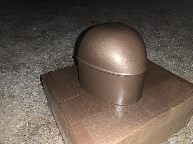

A test round of paint. Yes, the photos are right side up!
