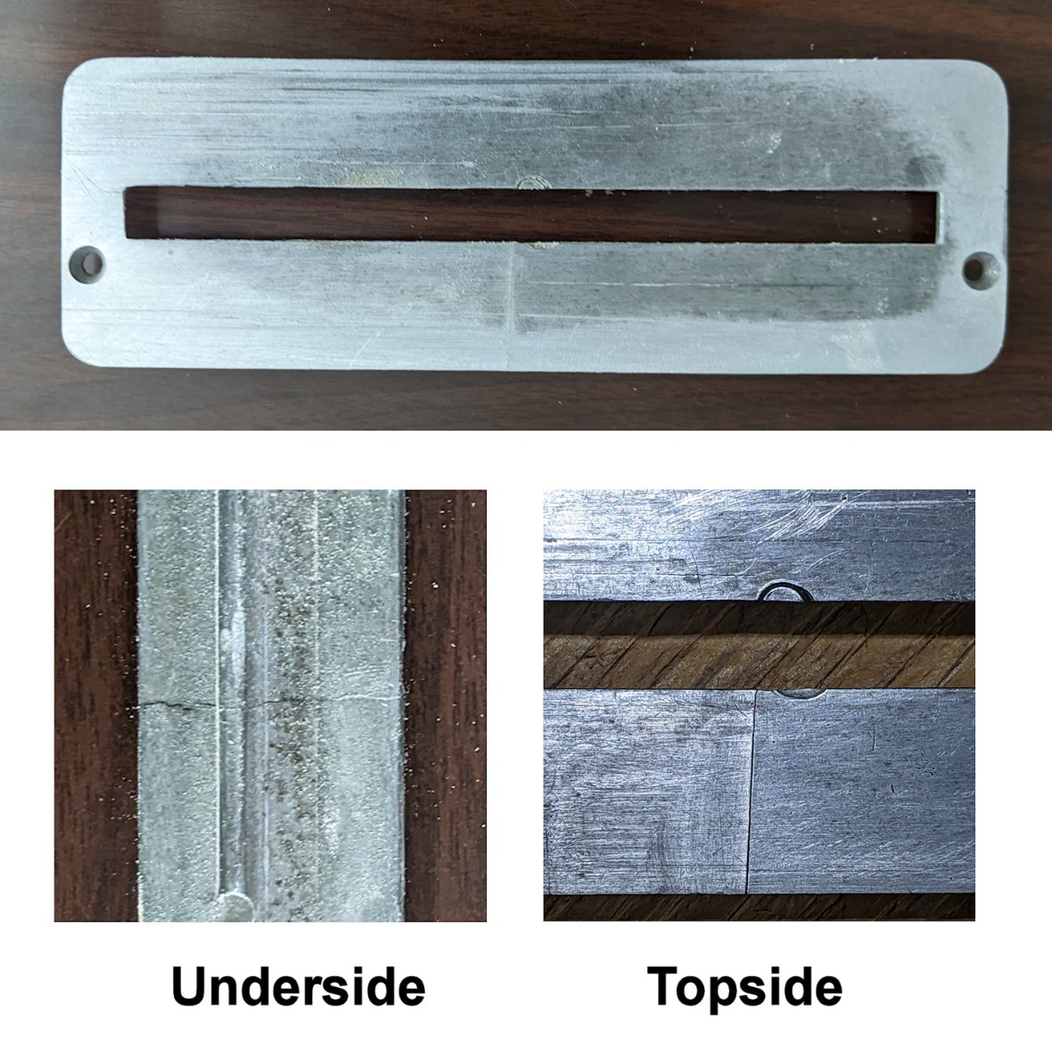

rpd wrote: Sun Jan 30, 2022 1:39 pm I believe this is the seller Russ is referring to, he sells new table inserts, and other 10ER parts.
https://sites.google.com/site/hogwinslowwoodworking/
To repair, I would try attaching an aluminum plate to the underside of the insert with JB Weld.
I did that to repair a broken speed changer and it has worked well.
viewtopic.php?p=233908#p233908

As for repairing the cracked insert do remember that they are only supported from the ends so any repair must support the location of the repair. Fortunately for you it is only cracked on the one side.

Hobbyman2 wrote: Sun Jan 30, 2022 11:43 pm Wouldnt the heat from brazing or welding warp it ? Harbor freight has aluminum welding rods that you use with a torch ?
Hobbyman2,
I actually have a MAPP/Oxygen torch.
I will probably give it a try.

Hobbyman2 wrote: Sun Jan 30, 2022 11:47 pm https://www.mastercool.com/product/alum-bond/
I have never used it .
Another great suggestion!

garys wrote: Sat Jan 29, 2022 9:04 am I have to question if that is a crack. The line I see appears to be too straight to be a crack.
The image below more clearly shows the nature of the crack.
garys wrote: Sat Jan 29, 2022 9:04 am Also, the machining marks don't match up on the two pieces. It appears that those were never one piece.
The machining marks were made on two different occasions.
