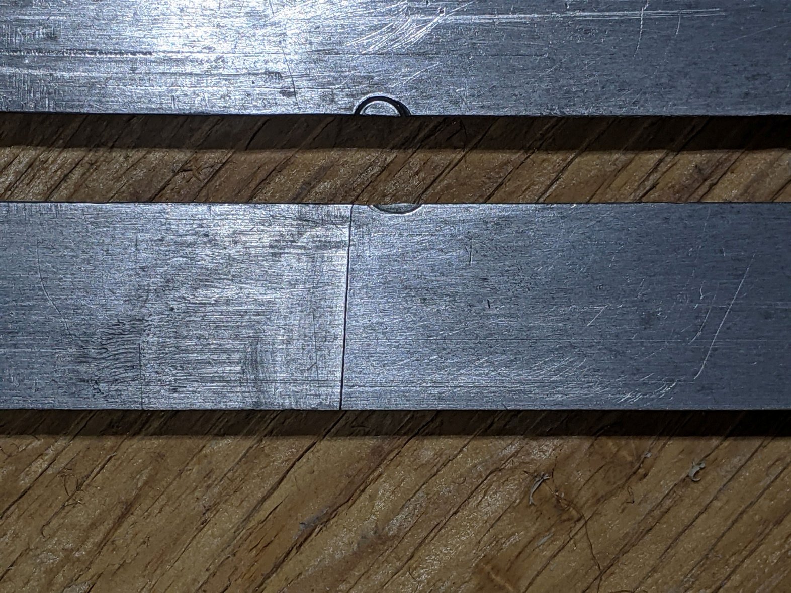

A couple of years ago, I noticed the table insert for my 10ER had a crack in it.
Does anyone have any suggestion on how or where I can get it repaired?

- Cracked Table Insert Small.jpg (473.26 KiB) Viewed 1479 times
Re: Can I get a cracked table insert repaired?
I have to question if that is a crack. The line I see appears to be too straight to be a crack. Also, the machining marks don't match up on the two pieces. It appears that those were never one piece.

I have one that is broken completely in half near the middle like your crack in just the one side of the blade slot. Someone who can "weld" aluminum could fix it but do not allow the "weld" to get in the way of it sitting properly in the table opening. I haven't tried fixing my broken one yet. Another option would be finding a used replacement or a substitute insert. There is a seller on ebay (also a member here) who made replacement inserts out of aluminum plate stock that fit very well as an option. I don't know if he still has them available since I haven't noticed them for a while.

The one I have that is broken all the way across has straight lines like the one shown above. The "machining marks" are not normal and are likely some damage from not protecting the table/insert top. Possibly drilling with brad point bits.

To repair, I would try attaching an aluminum plate to the underside of the insert with JB Weld.
I did that to repair a broken speed changer and it has worked well.

As for repairing the cracked insert do remember that they are only supported from the ends so any repair must support the location of the repair. Fortunately for you it is only cracked on the one side.

Wouldnt the heat from brazing or welding warp it ? Harbor freight has aluminum welding rods that you use with a torch ?

Garys,garys wrote: Sat Jan 29, 2022 9:04 am I have to question if that is a crack. The line I see appears to be too straight to be a crack. Also, the machining marks don't match up on the two pieces. It appears that those were never one piece.
Excellent observations!
Let me investigate further and get back to you.

Russ,chapmanruss wrote: Sat Jan 29, 2022 1:45 pm I have one that is broken completely in half near the middle like your crack in just the one side of the blade slot. Someone who can "weld" aluminum could fix it but do not allow the "weld" to get in the way of it sitting properly in the table opening. I haven't tried fixing my broken one yet. Another option would be finding a used replacement or a substitute insert. There is a seller on ebay (also a member here) who made replacement inserts out of aluminum plate stock that fit very well as an option. I don't know if he still has them available since I haven't noticed them for a while.
garys,
Thanks for the insight and suggestions!
Yes, the damage circled below was done when I was seven-hole punching stacks of paper to fill my Day Planner with non-proprietary paper stock.
