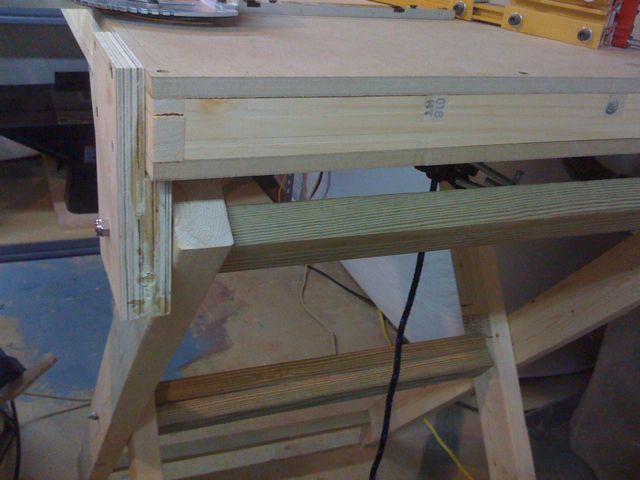

1. The sliding legs are just riding on the bottom of the table. I contemplated putting a sheet of high density plastic on the underside of the table but opted for keeping the edge of the 2x4 the only thing touching - figured the low surface area would keep friction down. The sliding legs are kept in line with the table by strips keeping them from getting "cockeyed" in the underside.
2. The fixed legs are attached to the side bracket and they too touch the underside of the table. Let me explain: The weight of the table wants to flatten out the "scissors". The side brackets trap the fixed leg side although they still want to rotate (flatten out). The upper edge of the fixed side rotates until it contacts the underside of the table. Since both moving and fixed legs are a) the same length, b) pinned at the same height, and c) attached to the same plane (underside of the table) gravity takes care of leveling the table. The only time this would not be the case is if you raised the table high enough that the fixed leg rotates vertical enough that the threaded rod carries the load.

Yes, that helps. I probably would have seen the issue with lowering the table sooner or later, but your thoughts are correct. That would be a real bummer lowering that thing. Might cut off some fingers!!
I am still having difficulty seeing the way the fixed legs are fastened. Is this where you have the threaded rod running through the legs and the drop piece on the side of the table? Is that rod inside one of the cross members?
Thanks again.

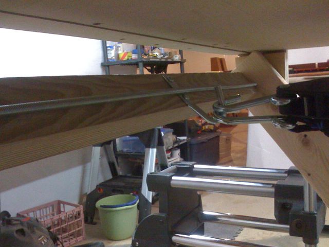

So from one side of the table to the other:
Nylon lock nut, table attachment brace, 2x4 outer leg with hole, 2x4 spreader screwed to outer legs on both sides, 2x4 outer leg with hole, table attachment brace, nylon lock nut. Run threaded rod through the whole mess. It doesn't go through the spreader just close to/against it.
- rod detil1.jpg (41.83 KiB) Viewed 5530 times
- rod detil2.jpg (45.85 KiB) Viewed 5507 times
