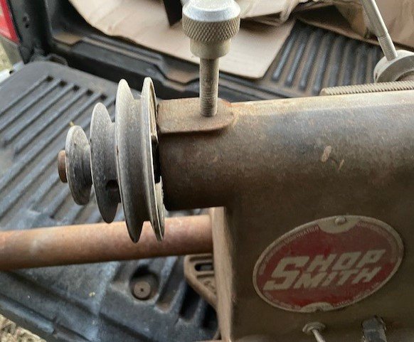

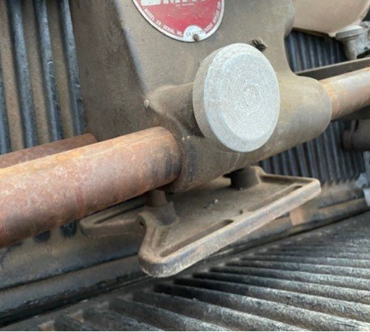

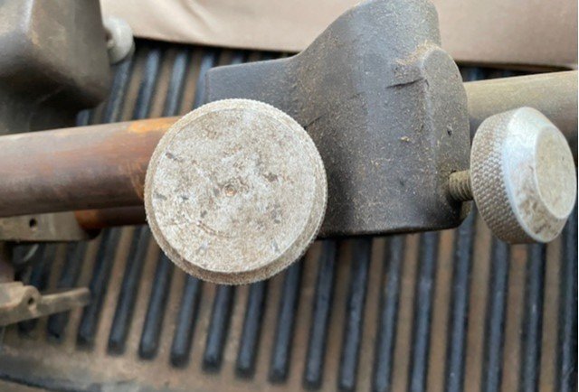

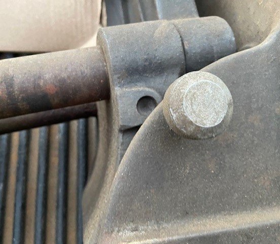

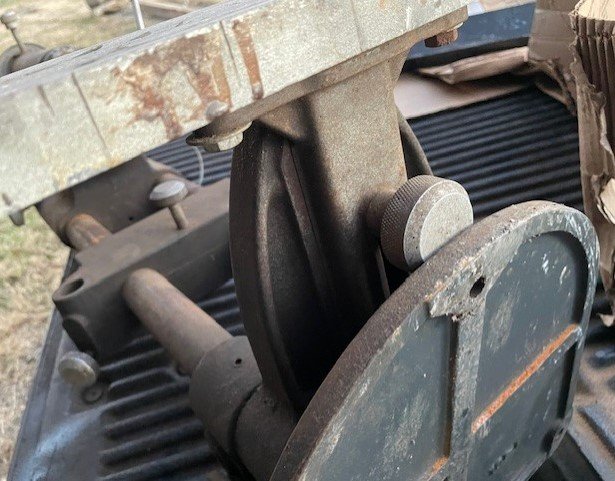

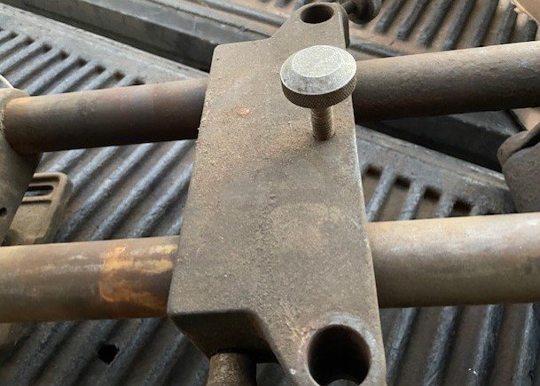

Here are a few pictures of my purchase today.
I will combine the 3 10ER's and the 1 10E that I have purchased and see what I wind up with. :D
I have not seen this knob type in this location ? :D
These are some big old knobs. :eek:
This one is the same size Big knob. :)
Dwayne
Posts: 4533
Re: 10ER Lathe Extension
Dwayne,
Since you now have 1 Model 10E and 3 Model 10ER Shopsmith's you may start to notice some differences in the parts. The biggest changes were in the Headstock Casting itself which has 7 different versions and the most changes of all the parts. These are sometimes very small changes but changes none the less. A major change occurred for the Model 10ER in April 1951 with the change from Double Wedge Locks on the Headstock and the Carriage to Single Wedge Locks. It is the changes made throughout the production of the Model 10's that owners have to be careful to make sure that when parts are needed that they get ones that are compatible. There are parts that did not change throughout the Model 10 production like the Arm for the Base end of the Bench. Some changes are harder to see like the Way Tubes changing to a thinner wall tube near the end of production. Those are the same Way Tubes used for the Mark 5 when it was introduced in 1954.
Out of the 11 Model 10E and 15 Model 10ER Shopsmith's I have owned/own the serial numbers range from 1033 to 101291. Some with the "R" serial number prefix but none with the "E" or "ER" prefixes. Serial number 1033 is from the first ones made in 1947 and 101291 was made near the end of the Model 10ER production in 1953.
In your pictures 3, 4, 6 and 7 there are knobs in strange places.
Pictures 3 & 6 have the Carriage with a knob (in pic 3) in the hole on top of the Carriage which that threaded hole is for the Table Riser Crank and pic 6 has a knob used for the lock. :confused:
Picture 7 has a knob being used for the Way Tube Lock on the Headstock and pic 4 has what looks like the rear lock knob for the Rip Fence in the hole for the Belt Cover bolt. :confused:
All very odd since those Knobs in incorrect places. In pictures 3 & 4 they are not at all functional there but the Knobs used for locks in pictures 6 & 7 may work as Way Tube Locks for the headstock and Carriage. :rolleyes:

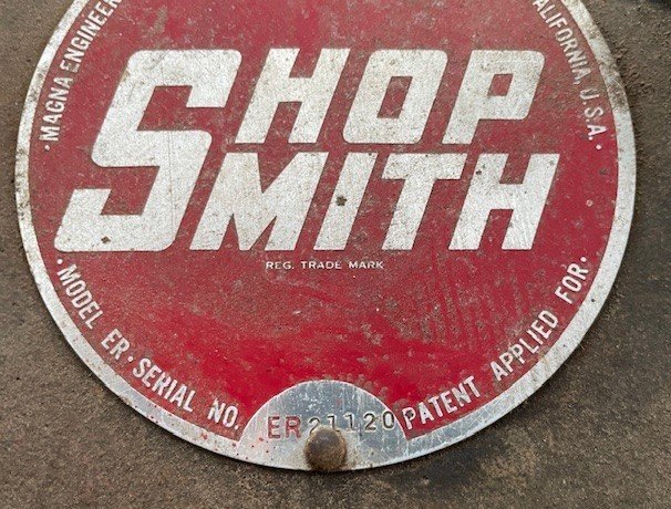

I am starting too notice some differences. :)
The 10E I have is E-3868 and the 2nd one I bought is ER26854 the 3rd one I have yet to see, as one of my friend's has it in storage a few hours away from me. And as pictured this one is ER21120.
This one came with no motor.
I have been looking thru the link you sent me in the other thread with all the differences in the castings and parts.
I have been studying these randomly placed knobs :eek: :D
The knob in the Headstock and one of the knobs on the carriage are huge compared to the other machines I have bought. :)
Since this will probably be the parts machine. :eek:
I will replace the ones missing on the others.
I will compare to your pictures of yours that you have restored.
Dwayne

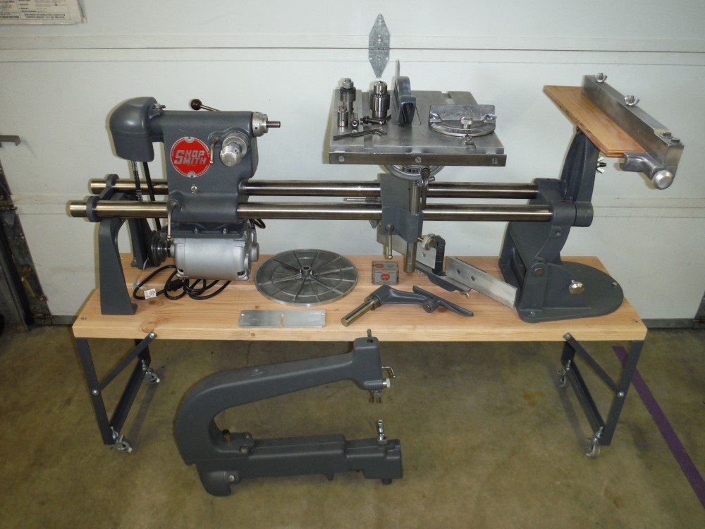

We have gone a little off topic here, but I am going to add one more off topic post. The Model 10E below is very similar to the one you have S/N E-3868 that I restored and is complete plus a bench, the Jointer/Shaper Fence and the Jig Saw.
_
10E 8865 r.jpg (116.22 KiB) Viewed 16873 times
The Model 10E below is similar to the other two Model 10's you listed. It is one I restored that also includes a Bench.
_
10E 25951.jpg (97.98 KiB) Viewed 16873 times
These are ones that I have the best pictures of that are close to your Model 10's.
