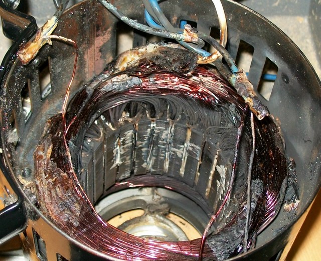

billmayo
Posts: 2342
Location: Plant City, FL
Emerson Motor
Post by billmayo »
dusty wrote:When I went to pick up my pool pump motor today, from the motor shop that does my motor work, I asked about the bushings that I discovered to be in the Crafter's Station motor.
He was not surprised at all that there were bushings and not bearings. He warned thought not to allow them to go dry. He said that when operated without periodic oiling they will last a long time but will then fail suddenly with little or no forewarning.
He reports that many small motors were built this way in the past but that very few are done that way now. He doubted that Emerson makes this motor today but was unable to confirm that because the motor data is proprietary.:mad: The part numbers that I was able to give him would not cross reference in his system.
I have an Emerson 1 1/8 HP motor from a Mark V 520 that has the bushing on one end. It has a 6203 (17mm ID, 40mm OD) bearing on the sheave end. There is no oiling hole anywhere on the end plate for the bushing. There was the cotton looking stuffing all around the bushing that was oil soaked. This is the first bad motor I have seen. It was actually on fire while it was running until it shorted out. If anyone is interested in seeing a really burnt motor, let me know as I have a few pictures as I disassemblied the motor.

billmayo
Posts: 2342
Burnt Motor
Post by billmayo »
dusty wrote:Bill, do you know the cause of the fire? Electrical or mechanical.
Yes, please do post those.
No, I do not know or could even guess what caused the fire but the motor appears to have been operating when it caught fire as the was a smoke trail out of the motor and motor pan. I plan to look more closely to see if I find any cause. First one I have been unable to repair in over a dozen non-operational motors. This motor has the bushing on one end. I am still resizing the pictures to fit but got this one done.
[ATTACH]7261[/ATTACH]
