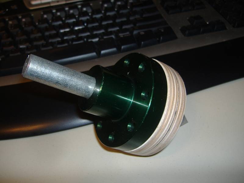

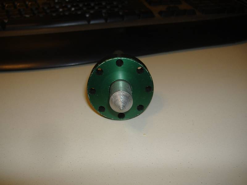

I have been working though design constrains and what parts I can find off the shelf. I had originally planned to use a larger dia. light saber but then came into some problems so I reduced the size and even purchased the 2" faceplate. I have since did a minor redesign and now can and will go with the larger size again. Are you confused?
OK, the purpose of the lathe faceplate is to drive a cylinder, in order to do that it must slide on a 5/8" shaft and then be attached to a drive "wheel". Here are a couple of pictures showing a 5/8" shaft passing through the faceplate and then a shot of the hole pattern on the faceplate from the front side.
[ATTACH]8052[/ATTACH]
[ATTACH]8053[/ATTACH]

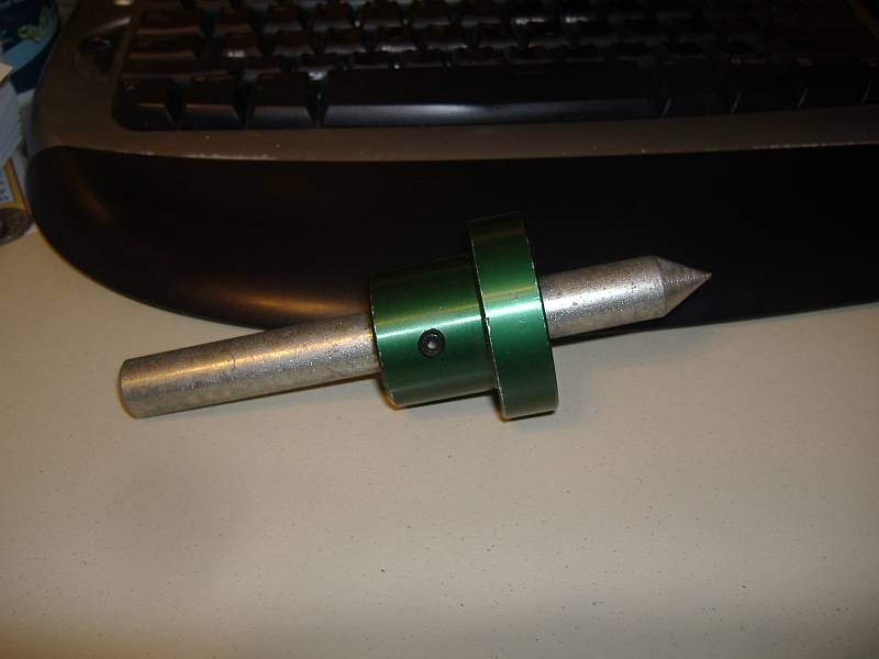

Anyway the 2" version is now going back to life as a 2" faceplate and a new 3" version has replaced it for this project. The next picture show how they will mount together, that being the faceplate and the "wheel". I plan to use 4 screw between the faceplate and "wheel" more for balance then need for that much drive power. Hope I have the right size and length screws in stock so I can continue on this project without going to the hardware store.
[ATTACH]8054[/ATTACH]
Slowly but surely things are starting to come together.
