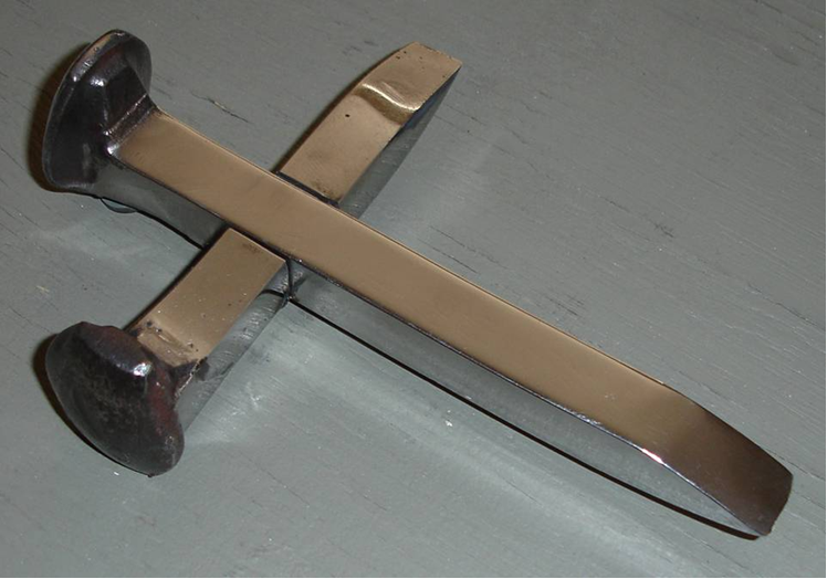

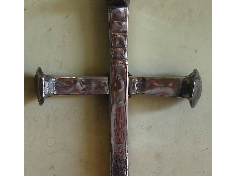

As for polishing (the original topic of this thread), a buddy of mine is an armature metal worker who also restores Jeeps. For Christmas last year I bought some rail road spike crosses he had made (see attached photos). He was able to achieve a mirror finish on the fairly soft steel with a series of three polishing compounds: black emery, green stainless, and chrome/jewelers rouge. So if it can be done for old RR spikes, a mirror finish should be possible on steel tubes. At least it is until I attempt it personally. ;) Once again, Mickyd has the subject thoroughly covered in a How-To Guide in a post that also covers aluminum polishing.
