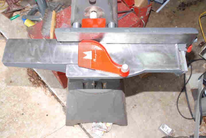

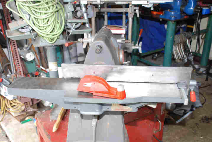

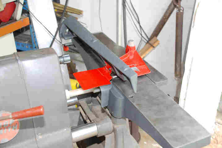

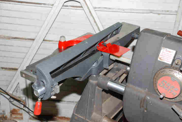

This morning, I got everything back together. The only causality was a blister on my little finger, when I was trying to align the height of the offset tubes for the drive hub.
I used silicon lube for the depth adjustment screw, and in-feed table supports.
I aligned and squared everything. and finally waxed all the unpainted surfaces.
I originally wanted green paint, but actually I kinda like the gray after everything is said and done.;)

Post by SDSSmith »
Looks great, Jim! Have fun with it and be safe! Though I think the headstock is now jealous or is it green with envy? No it's still gray.;)

Post by terrydowning »
What method/materials did you use for cleaning the fence and top?
How did you make sure sure these were true?
I have a jointer is similar condition as your starting point.

Post by Fla_Jim »
terrydowning wrote:What method/materials did you use for cleaning the fence and top?
I used a 2" twist lock "scotch brite" abrasive pad with a pneumatic angle grinder.
I got everything at Harbor Freight. The grinder was less than $20.00 bucks.
The jointer tables didn't have any pits, and as per the pictures, cleaned up very good.
I checked the tables for warpage, and that the two tables were coplanar.
I used a straight edge, and feeler gauges.
