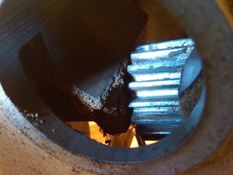

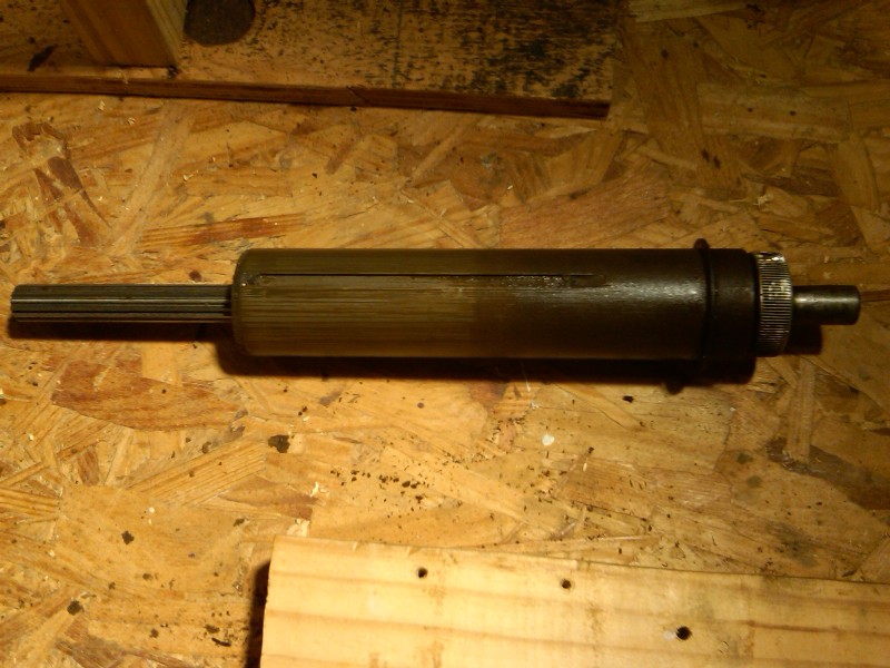

I vote rust and gunk if it looked like this.
[ATTACH]11426[/ATTACH]
[ATTACH]11427[/ATTACH]
