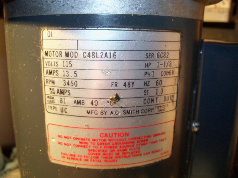

Once I started to clean the motor off it seems almost brand new, any idea if it was replaced or where I can find a date of manufacture.
