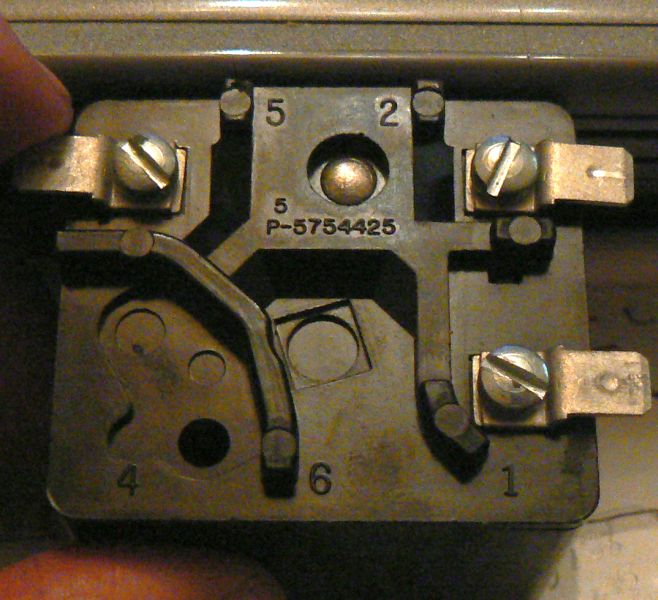

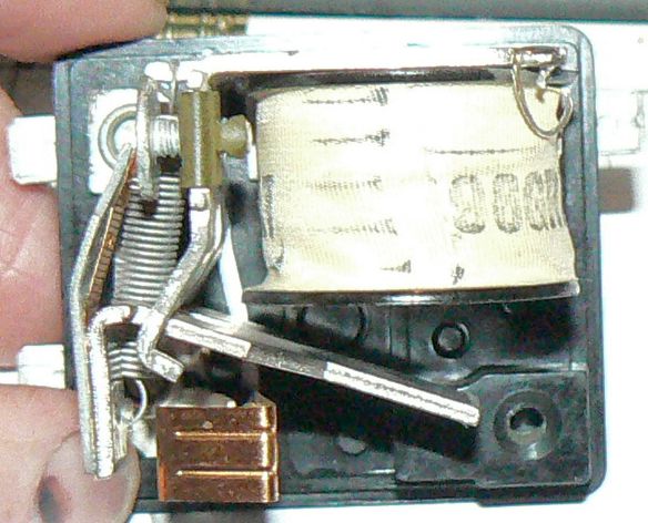

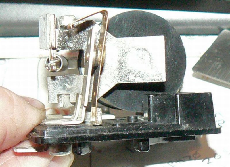

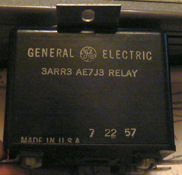

GE 3/4 hp motor start relay
Here is what the start relay looks like.
[ATTACH]12682[/ATTACH]
[ATTACH]12683[/ATTACH]
[ATTACH]12685[/ATTACH]
[ATTACH]12686[/ATTACH]
[ATTACH]12687[/ATTACH]
The relay coil is between terminals 5 and 2.
The contacts are between terminals 1 and 2.

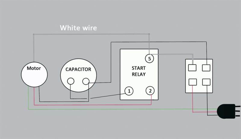

Big Question
Is the white wire not the AC return in this motor setup? or is this being used 220VAC?
If it is the return, would there be current through the motor windings?

dusty wrote:Is the white wire not the AC return in this motor setup? or is this being used 220VAC?
You Betcha!!! Right out the top of the motor in that wiring drawing. The wire broke off terminal 5. That left the contact(closed) and capacitor in series with the start winding. Both the start winding and the run windings are connected internally to the white neutral wire of the motor. 120 v only!
P.S. The terminal that broke off the relay terminal 5 'spliced' the motor wire and the wire from the switch.
The capacitor and start windings only operate at 110 VAC. When doing 220 VAC input, the start windings are only connected across only one of the two run winding coils.JPG40504 wrote:Thank You for the opportunity to get familiar with this version motor. I may decide to make it reversible or maybe also 115/230 V. Depends on what I 'discover' when I replace the original rubber insulated external wires.
