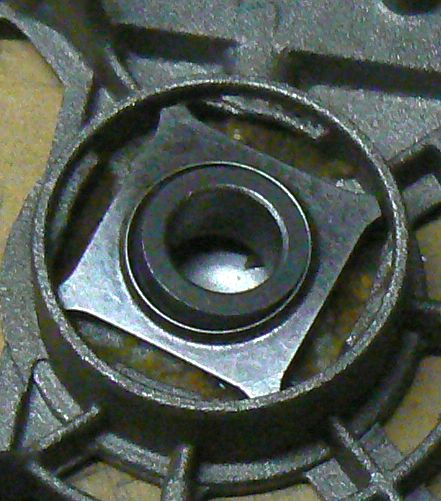

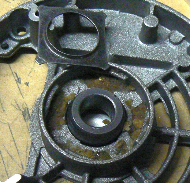

Power Station Motor 'Bearing'
Well I finally got it back together. Bill Mayo requested pix etc. of bearing ... This will involve 2-3 posts to allow all the pix.

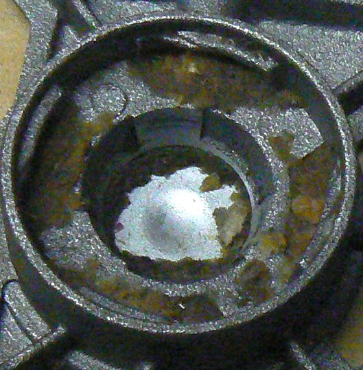

[ATTACH]12499[/ATTACH]
The end cap bearing 'socket'. Allows bearing to pivot.

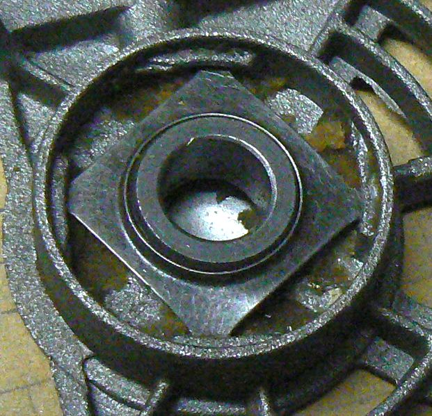

[ATTACH]12500[/ATTACH]
Add bearing. Square plate retains bearing and tensions it. The corners must be simultaneouslt depressed and rotated into 4 grooves.
[ATTACH]12501[/ATTACH]
Retainer/flat plate spring.

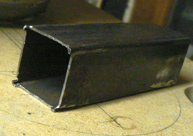

[ATTACH]12502[/ATTACH]
Tool made to compress corners so it can be rotated into 'slots'. Once in slots, a shoulder prevents it coming back out.

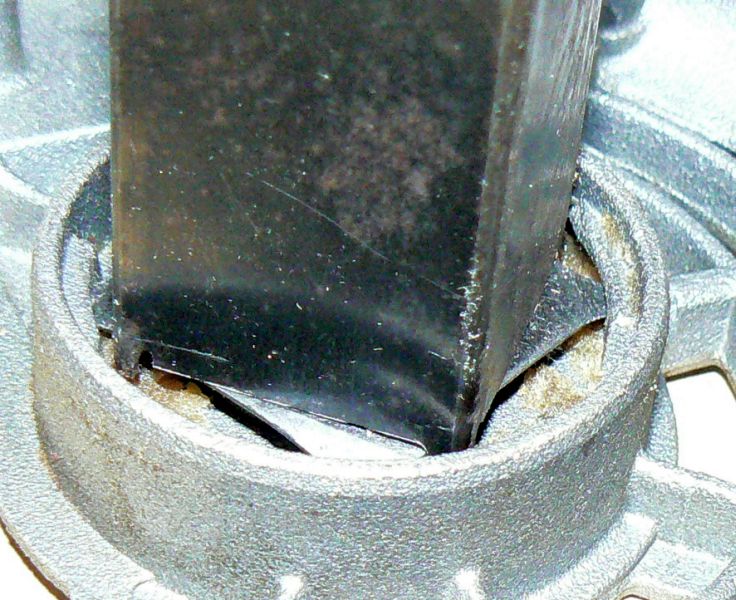

[ATTACH]12503[/ATTACH]
Depressed and rotated into 'slot'.

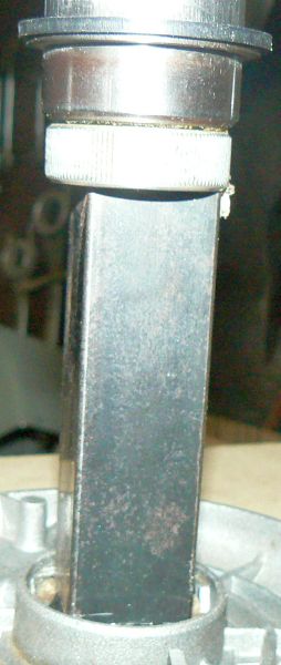

[ATTACH]12504[/ATTACH]
Use SS quill as a press.

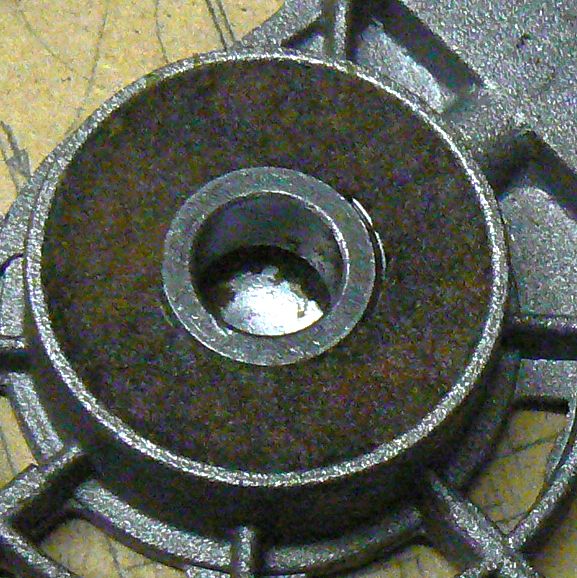

[ATTACH]12505[/ATTACH]
Retainer plate in place
