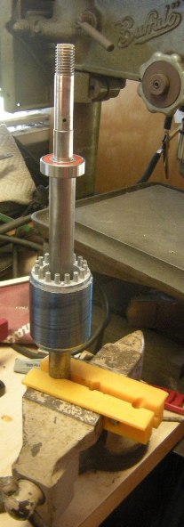

[ATTACH]12860[/ATTACH]
This has gotten a fair amount of use on motors and drive sleeves. I make hardwood accessories bored for the appropriate shaft size. So far so good.
Installing Motor Bearings without a Press
Good call on the threaded rod and washers
That was a good idea regarding using threaded 3/8" threaded rod as extensions. I had some 1', 2' and 3' sections in my shop and just used the HF puller to reposition a set collar on an extra long shaft (not a SS piece of equipment). Thanks again:)

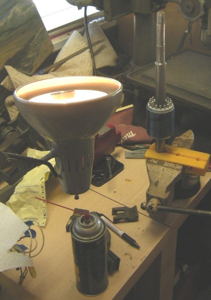

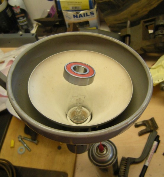

light bulb bearing heater
I (and others who rebuild) heat bearings on a 60 watt light bulb for about 10-15 minutes, makes them expand a few thousandths and installation is much easier. Nope, the heat wont hurt them as its lower than that generated while the bearings/motor's turning.
