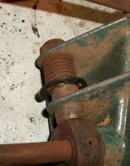

I took out the clip on a set of casters to get a better look & decided to try a Harbor Freight E-clip from one of their assortment boxes, Here's a pic of the result. Seems to work fine, stays in place when I rotate the cam.
I don't see why it wont work as long as it stays in place & it seems to.
