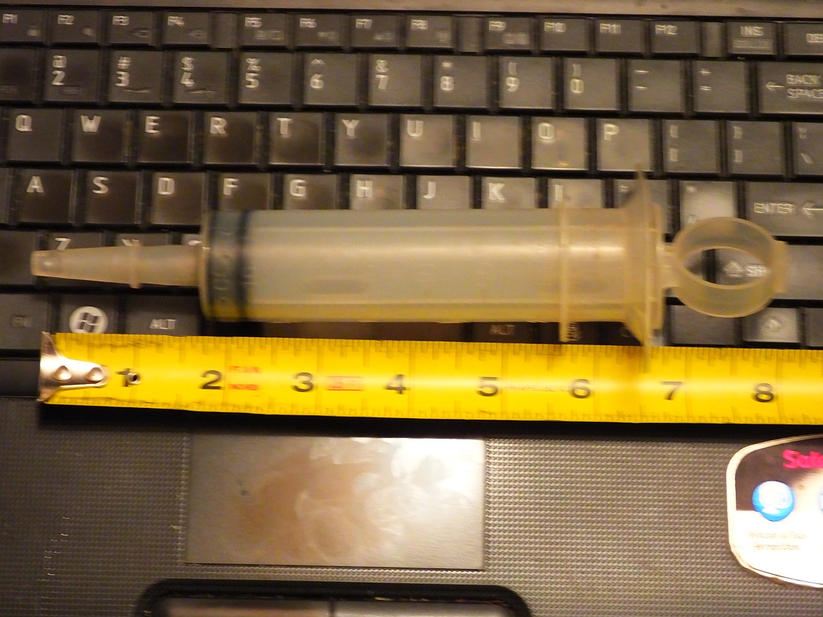

Re: A Slow Boat To Nowhere
Your syringe was not big enough.
This is what I had in mind!
algale
Posts: 4841
Post by algale »
JPG wrote:Your syringe was not big enough.
That might have been too big. Is the tip 1/4" diameter or less?
