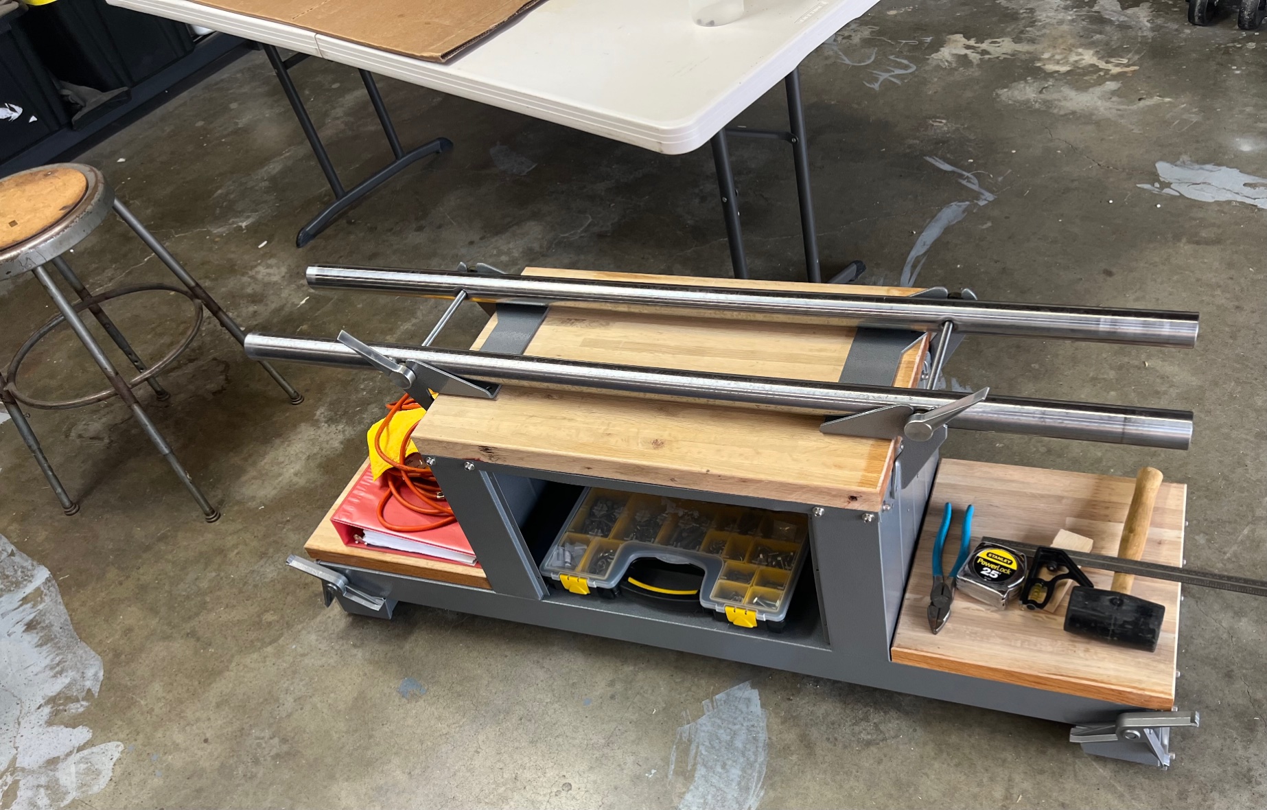

Walking and chewing gum, pic of tops that are not finished. Everything seems to function as it should hopefully get to electrical later today. Bout all I can do till later on in the month.
- 843A3955-01F3-4920-98BD-97D9576EF20E.jpeg (691.66 KiB) Viewed 2659 times
