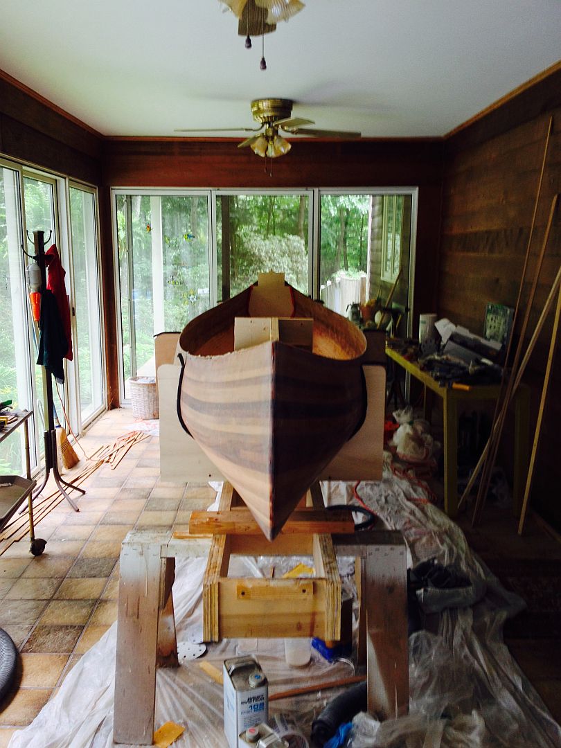

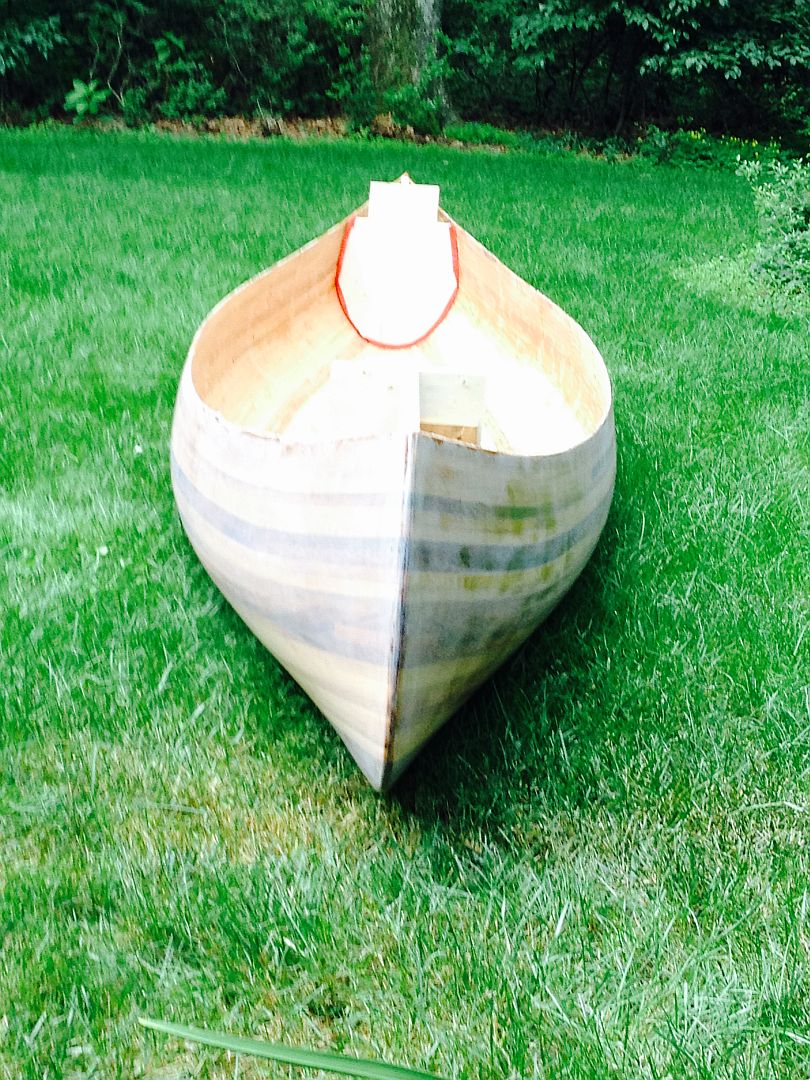

A momentous day for the slow boat! Off the mold!
Right side up!
In the cradle!

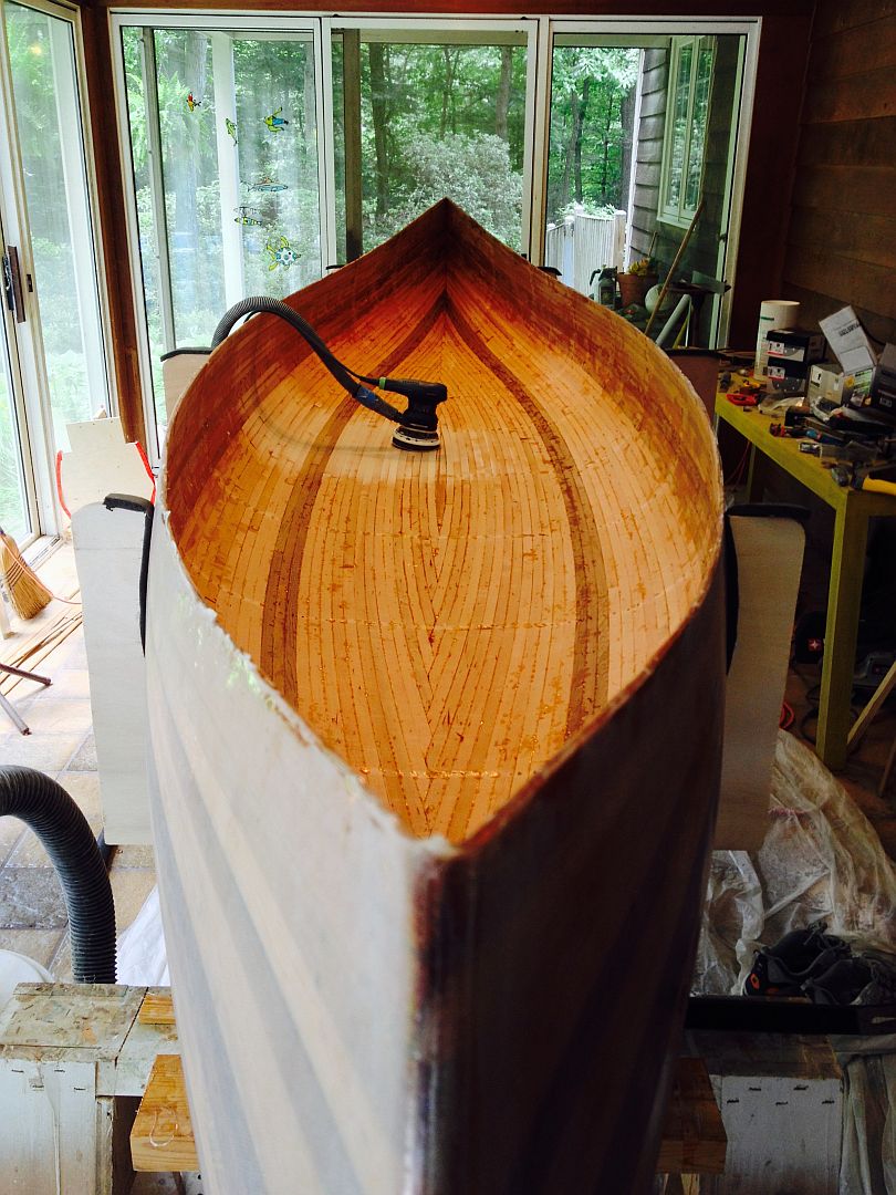

So...much...sanding to do!

That is a piece of work for sure! :eek:
You are still welcome to bring it to our lake, 12 months a year available ..... :D

You and Roamer may "Splash" at about the same time. :D

Beautiful! When they are right side up it becomes clear why they are called "vessels"
Idaho Panhandle
Re: A Slow Boat To Nowhere
Wow! When right side up, it becomes a new project. So pretty looking - it's almost scary to do the inside work. Nice you can carry it outside once and a while to re furbish the porch.
It's been fun following the story. How does the young man feel about it?

He's excited to get on the water with it. He's not excited to help do the woodworking. It's ok. Maybe someday he will take an interest.

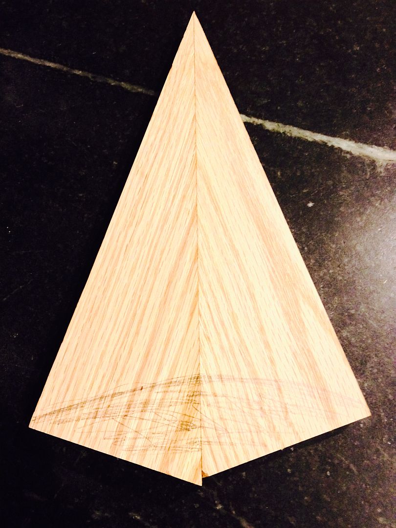

Taking a break from sanding the interior, I want to make my canoe decks so the grain lines converge. The technique explained in one of my canoe books is to cut a rectangular piece of wood along the diagonal between opposite corners, which gives two right triangles. One triangle is flipped and rotated and then the two triangles are then joined along their hypotenuses.
I decided to experiment with some oak I had laying around (the real decks ultimately will be made of sapele). I started with a board 12 x 4 x 3/4. I drew the diagonal and then cut it free hand on the band saw.
Here's the result. The grain lines do converge. The bottom will be cut in a semi-circle, which is marked very roughly with pencil.

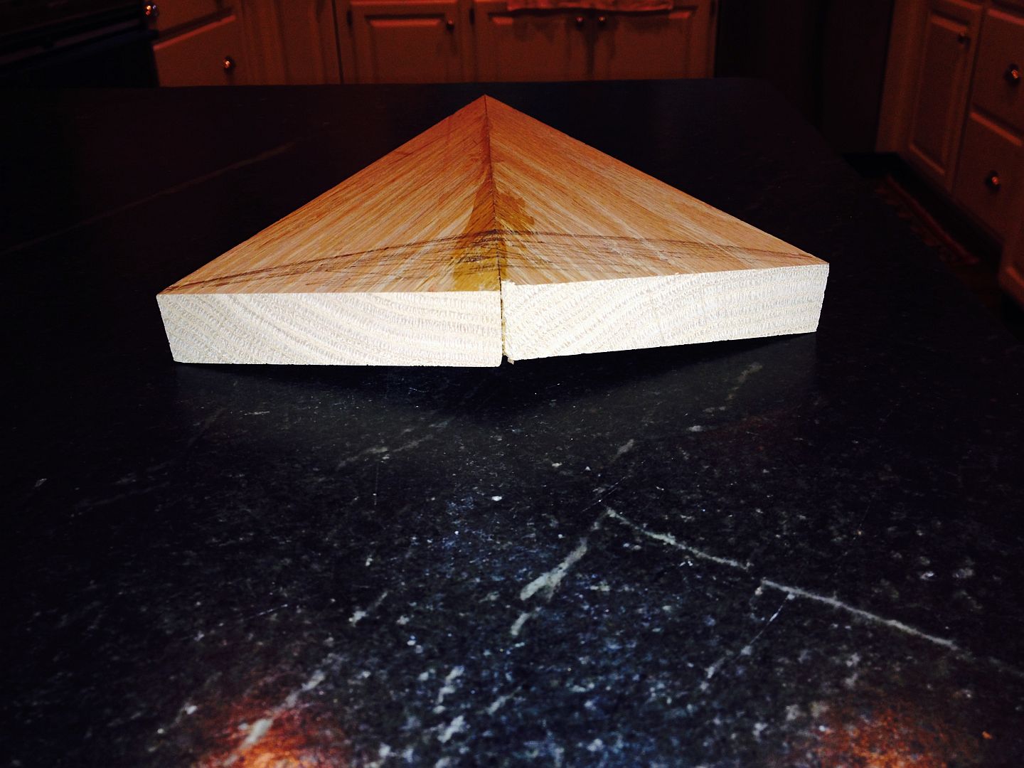

Now, to complicate matters, I wanted to put a slight crown or camber on the deck. To do this, I decided to put a slight angle on the hypotenuses. I decided to put a 5 degree angle on each side.
Here's the result.

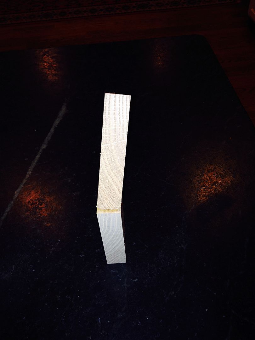

And a view standing on edge to better show the angle between the two triangles.
I spent a lot of time thinking how I could use the Shopsmith to cut those angles along the hypotenuses of the triangles. No obvious solution presented itself to my feeble mind. Ultimately I gave up and used my jointer. I set the jointer fence to 85 degrees put the hypotenuse down, registered the face of the triangle to the fence and fed one triangle point first and the other base first so the angles would be in opposite directions. It worked, but I am interested how others would accomplish this on the Shopsmith.
