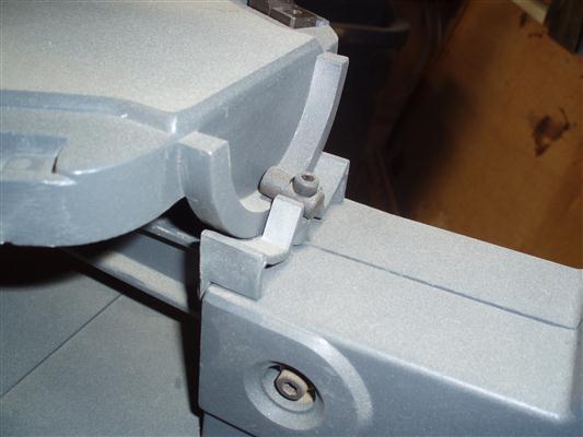

mrhart wrote:Dusty on the back of your last pic (rear cradle) there is a black cyliner for hold down or support maybe. Even with the Master Inside Mark V scroll saw exploded view (page 58) on 400% view, I don't see it. :confused:
I am not sure I understand. Are we talking about this image?
[ATTACH]18911[/ATTACH]
Do I need to post a different shot?
Is this what you are asking about? If so, it is just a hold down for the rear of the table.
In the parts list it is item #86 Lock Shaft 514985. The machine screw #85 screws into #87 514982 Cradle.

Yes sir those are the correct parts in your pic. On the parts list there is NO number 86, its skipped. What diagram do you have??

mrhart wrote:Yes sir those are the correct parts in your pic. On the parts list there is NO number 86, its skipped. What diagram do you have??
That is because the current diagram and parts list on Shopsmith's website is for the newer style scrollsaw. The rear mount on the new scrollsaw table is different from what you and Dusty have. Unless you have the manual (and thus part numbers) for your saw, you will have to contact Shopsmith to see if they have the table's rear mounting parts.
Rob in San Diego
There is a good chance they have the parts.
Check here and here.http://www.shopsmith.com/ownersite/itemfind.htm?item=514982&Submit=Find+Item

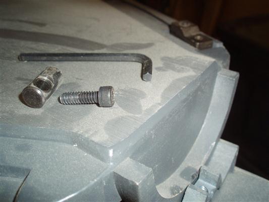

Part #86 is something mandatory and I need to make one somehow. Dusty, hate to have you get your screwdriver and camera out again, but could you give me some pics and specs on what I need to make. I did order the srew that goes through it though.

I received your PM regarding this part. I'll get out there today and take some pictures. If part #86 is your only show stopped, you'll be able to recover. The part is simple. Any machine shop could create one.
