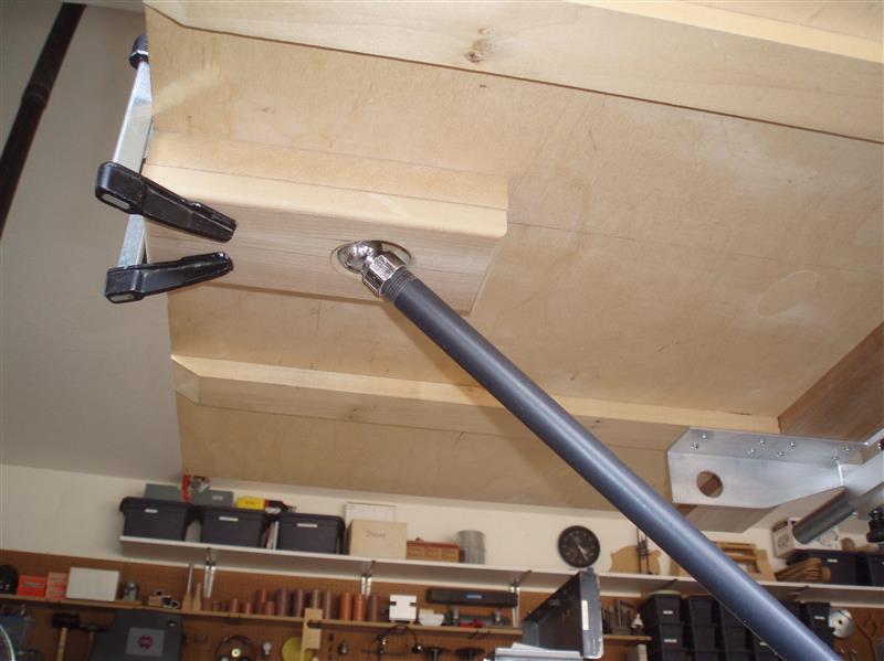

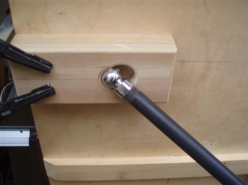

Way back when I first started this project I was thinking about some sort of universal joint. A ball joint arrangement. I never came up with a solution but I haven't given up.
Here is a possible solution that is in process now.
[ATTACH]20731[/ATTACH]
As soon as the glue dries the clamps go away and this phase is OVER.
[ATTACH]20732[/ATTACH]
Think upside down. This would go under the OFT at the top end of the support bracket.
New Upper Ball Joint 001 (Custom).JPG (56.04 KiB) Viewed 2317 times
New Upper Ball Joint 004 (Custom).JPG (49.23 KiB) Viewed 2321 times
