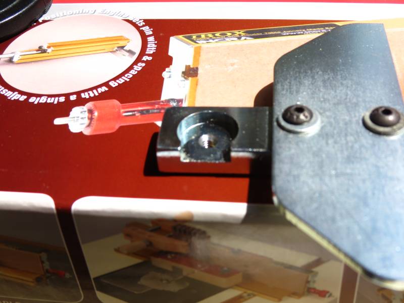

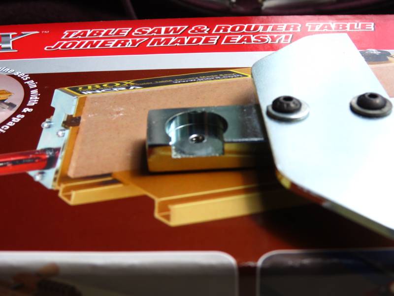

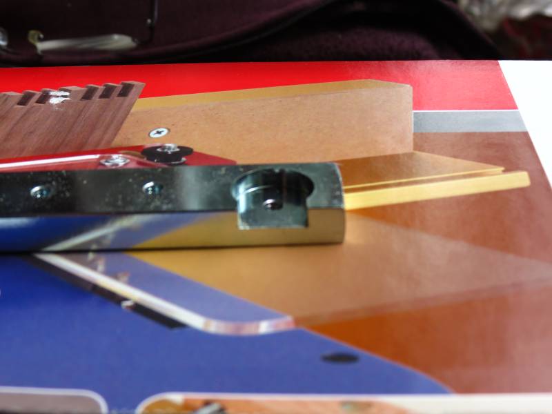

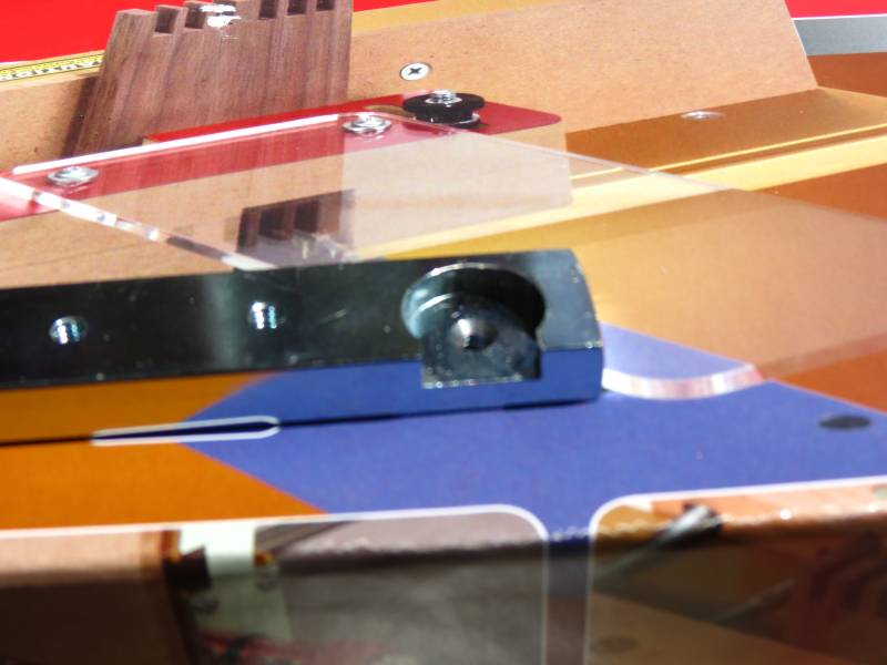

I'm back here this morning and I have news for you.
The problem is with the bar. The holes need to be countersunk and at least on mine they were not.
I've modified mine as shown in the pictures below.
Warning: The metal is very soft so go really slow (that is if you want to countersink your bar) and don't get carried away and make it too deep. The other option would be to send it back and get a replacement.
That small change made all the difference. I can now lock the miter bar in where as before I couldn't get a proper fit. So with the adjustment done properly it slides like I expected it to.
Mark also mentioned adding some grease on the treads might help. I did that too after making sure the countersink fix worked.
Slot location was also mentioned on the white disks.
"[font="]The orientation of the slots in the white discs makes a big difference...if you look at the bar from above, there's a "point" where the round edge of the disc pocket opens up at the edge of the miter bar, right where the pocket stops making contact with the edge of the disc - aim the slot directly at the point (this is roughly 2:00 or 4:00 for the discs on the right side of the bar and 8:00 or 10:00 for the discs on the left side of the bar). Or to phrase it differently, if you're looking at the side of the miter bar and you're looking at the edge of the disc in the pocket's opening, you should just barely see the slot at one edge of the opening in the side of the miter bar."
As for the other issue, mounting screw and guard bolt interference, they now have a new bolt with a shallower head, he will be shipping me out one to see. I guess you would need to contact him if you want one. I was almost going to say never mind but then I though I did pay $170 of this, why not.

Thanks for the updates. Did you use a countersink or twist drill bit to countersink the holes in the bar?
Mike907 wrote:Ed -
I used a countersink in my hand held drill. Of course it might be better to use your Shomsmith if you think you might have controlling the depth. You want as many threads left in the hole as you can.
Another hint, after doing the countersinking use the screw from the back side to clean any burr that might have gotten created during the process.
