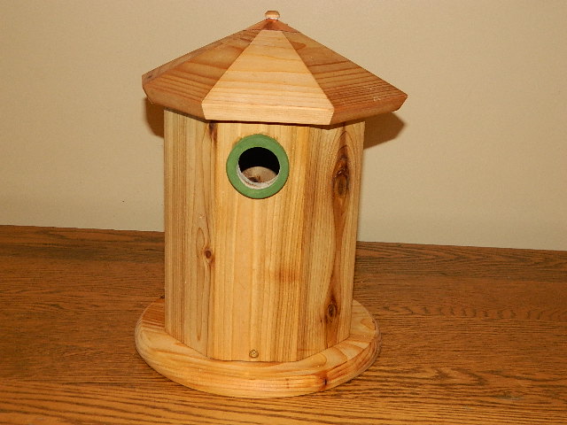

john wrote:I tried the miter saw but my blade was too rough and chipped the wood. Reverted to the band saw and by trial and error thought I had it all figured out. I glued up two sets of four panels and when I tried to attach them to the roof struts, they were way off.:mad: Oh well, my neighbour will appreciate all the scrap wood I have made for his fireplace

After my last post I decided rather than scrap the work, I might as well try to fix it. After all, if I didn't succeed, well it was scrap anyway.
I started changing the angles of the four roof pieces that had to come together. It took about eight narrow cuts on the band saw for each piece but I finally got to a point that they fit ok. Here is the result.
[ATTACH]24347[/ATTACH]
It's meant to be for chickadees and is still not perfect but I don't think the birds will notice that four roof panels are not the same size as the others, nor will they notice they don't quite meet on the bottom edge. That gap was filled with epoxy so water can't get in. The copper flashing covers the hole where the roof panels meet.
It's finished with a couple of coats of Tung & Teak oil for protection and to bring out the colour of the cedar.
I would like to try more but I have find a better way to make the roof panels. Maybe I'll have to spring for a better blade for my CMS to make cutting the angles easier, or at least more quickly.

Looks good.
I'm sure most discerning chickadees would be happy to move right in.
