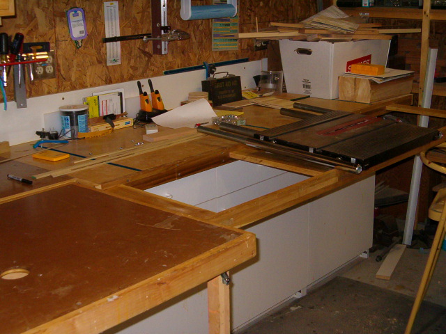

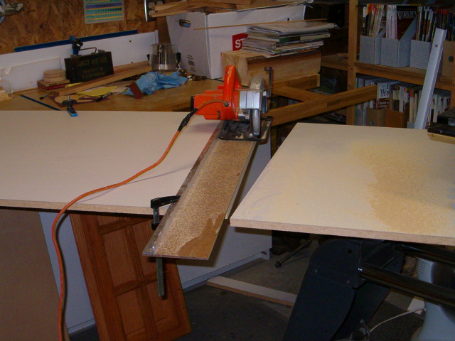

I love my workbench made from three layers of hard MDF. Why three layers? So I could have a slide out that increases the size of my bench to almost double.
In putting the three layers together, I left four spaces, each 4" wide. then I could slide four 4" boards (3/4" thick) into these spaces. Now, to finish the 4" slides and the edge of the slidout - I routed a stop groove into the bottom of the slides and installed a plug into the bottom of the bench. The plug fits into the groove and prevents the slideout from being removed from the bench. The outside of the slideout is made from three pieces of 3/4 x 3/4 hardwood.
The slidout allows me to litter the bench with tools and still have space to have a larger bench.
Here is a photo of using the slideout to support another puece of MDF while sawing.

I have a folding table that fits level with my workbench but I want to show the "Expanded workbench" to hold the Shopsmith main table.
table with expanded workbench.jpg (126.48 KiB) Viewed 9702 times

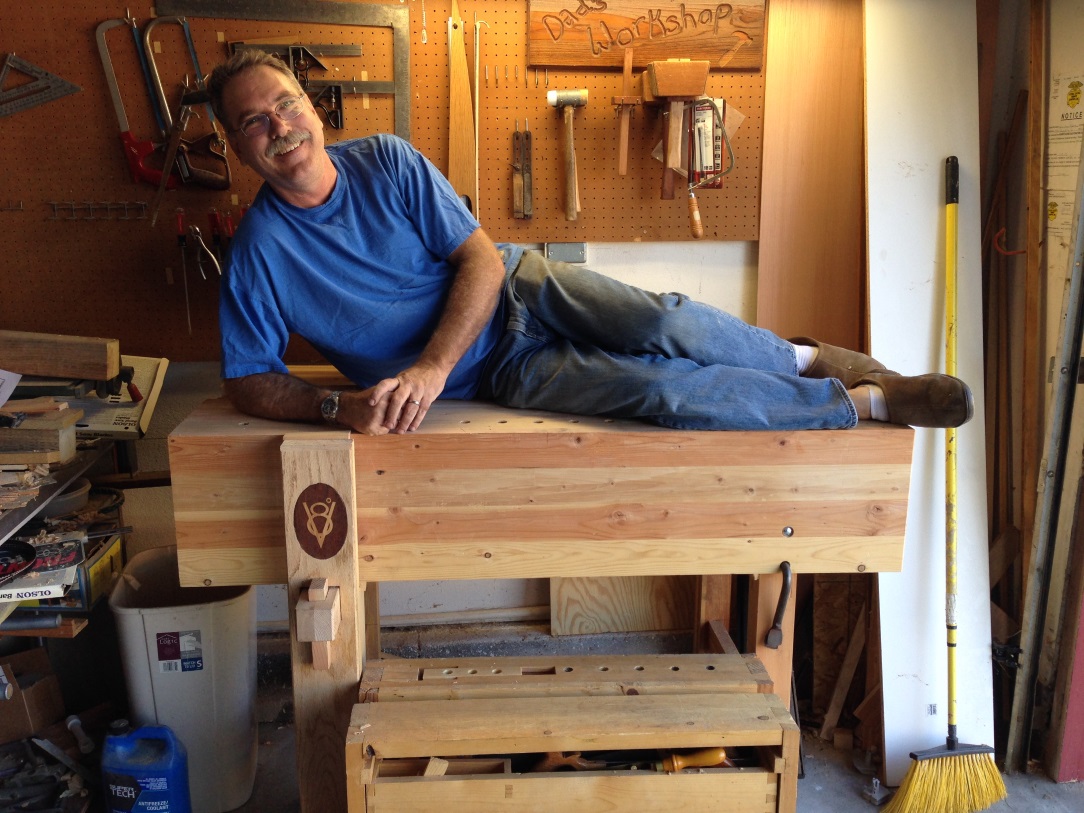

best bench I ever made is this one.
ALA Paul Sellers English Joiner's Bench.
but smaller 5 feet long, 22 inches deep.
2014-10-26 12.59.46SM.jpg (288.53 KiB) Viewed 9613 times
Nothing wrong with Big Big White wood IMO. The only thing that beats it is free/found wood.
it's a WORK bench not fine furniture.
Wagon vise and leg vise are wedge powered (Thanks shipwright!) and they do the job I need them to do.
Total cost on this bench was under $50. All hand tool construction principally used for working with hand tools. YES my "Good" planes do touch the surface of this bench and yes it was flattened with a very nice 22" Millers Falls Jointer. (flat enough for me.) Followed by my Miller's Falls smooth plane. After 2 years of use, it's time to clean and possibly flatten again.
just my .02 on the workbench subject.

terrydowning wrote:best bench I ever made is this one.
She's a beauty!
I'm curious ... the cash investment was a mere fifty bucks, but what was the time investment? I'd love to build one.

BuckeyeDennis wrote: She's a beauty!
the time investment was fairly significant as I did all of the work by hand. Yes, all boards were squared and hand jointed just like in Paul's Videos. Not too bad starting with dimensioned wood and I was very choosy when selecting the 2 by stock. Minimal knots, minimal warp, twist and bow etc.
The wedge powered wagon vice added to the time investment, but it's all hobby time anyways. I did the work on my back patio and enjoyed some good weather while working on it. So for me it was time well spent.
All told there were several days spent on the bench build. I added the leg vise later.
I do wood working for a hobby so I don't consider the time investment. Any time spent working on projects is "God Time". To borrow a phrase form the fishermen of this world. "The worst day in the shop is better than the best day at work." (Except if you injure yourself. which is another reason I have switched to hybrid woodworking.)
The bench is great and it does what I need it to do and has helped on many other projects.
