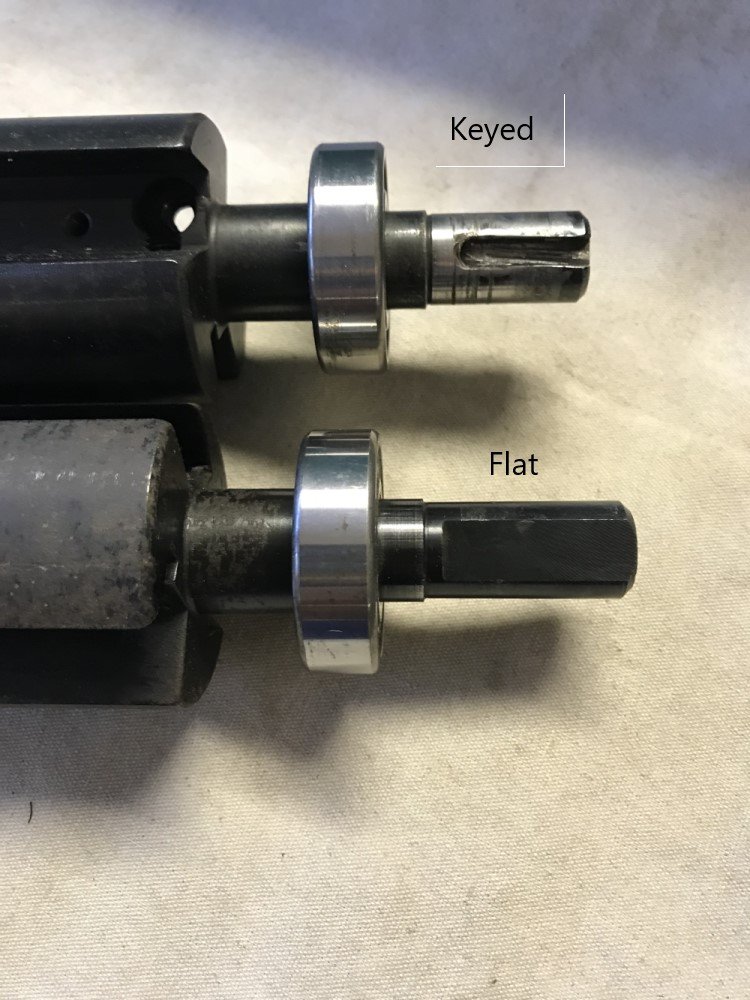

It sounds like you have an earlier Mark Mount Planer Cutter Head. The picture below shows both a keyed shaft and a reverse tapered shaft on the Cutter Heads. Later ones had both a Keyed side and a Tapered Flat side to the Cutter Head Shaft. No longer a need to have separate Mark Mount Planer and Pro Planer Cutter Heads. I don't believe the extra step of making a key to fit the pulley and reverse tapered flat is necessary. The set screw of the pulley against the reverse tapered flat should hold just the same as attaching a Power Coupler Hub for use as a Mark Mount Planer. The pulley may need a longer set screw to reach the reverse tapered flat than the one originally supplied.
Planer Cutter Head end labeled.jpg (132.44 KiB) Viewed 13800 times

by GEC
