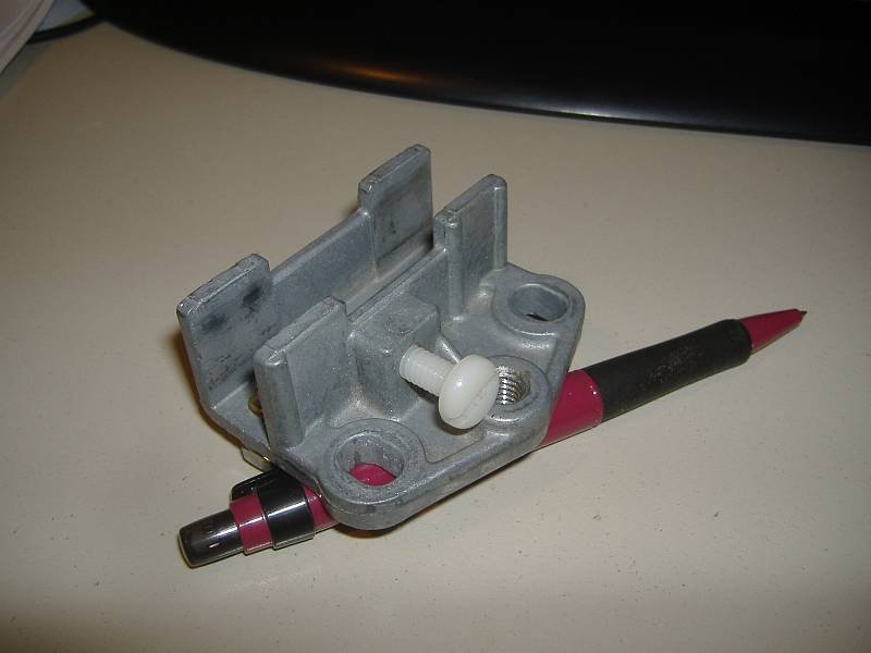

Curiosity got to me because I couldn't clearly see the upper blade guide assembly. Pulled it off, and measured the gap between post and bracket. There's 12 thousandths at the upper surface, and maybe 13 at the lower. If my rusty feeler gauge were a little longer, I'd rob it of the .012 leaf and wrap that through the guide block. But there is a tiny bit of axial twist due to the guide block surface opening up maybe an additional thousandth
The Bandsaw exploded parts diagram lists a nylon bolt (517908) and sort of shows where it screws into the guide (5025499). It's a little tempting to drill and tap a hole.

Oh, and my friend with the warped bandsaw offered to give it to me. RPD--Thanks for the link to the setup thread; I may attempt to save his bandsaw.

Adding the nylon bolt to the bracket as shown below will allow you to adjust out that gap. Get a nylon bolt long enough to extend just past the edge of the bracket to make adjustments easier. The one shown below is a little short but gives you the idea of what it should look like. I believe it was JPG that did a thread on this modification for older Bandsaws.
_ .
If you are uncomfortable drilling and tapping the bracket you can purchase the Guide Column Bracket from Shopsmith. It is part number 5025499 called Bandsaw Retainer for $19.93. The Nylon Bolt is also available and is part number 517908 called Screw for $3.99. I don't know why Shopsmith uses different names sometimes between the Manual's parts lists and the service parts online.
As for the warped Bandsaw it can be fixed. It is a matter of what is warped and how much you are willing to spend to correct it. We can help with advice whenever needed. I have owned, restored, upgraded, repaired, etc. seven Bandsaws ranging from 1956 (the one in my previous post) to 2006.

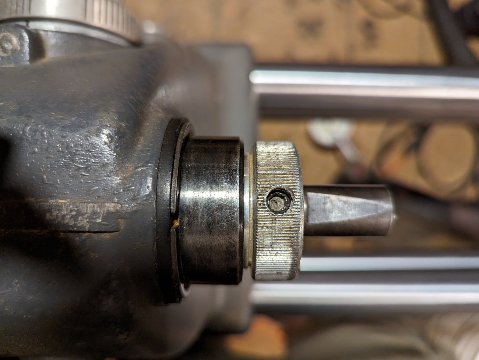

How much play in/out should a quill have? Mine's almost a 16th. Confession: I was standing there ignorantly when my friend (son of the previous owner) cleared the "sawdust" out of the setscrew and attempted to remove this "lock collar." Did we mess anything up?

Re: I have a friend (with a SS Mark V)
No, but you did the first step to correct.
The in/out play is eliminated(reduced) by pulling out on the shaft while pushing in the collar AND tightening the set screw WHILE making sure the setscrew is centered on the flat.
