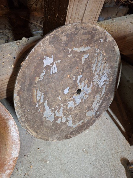

I've got two of these 12-inch sanding disks, but this one is really caked with something that looks like epoxy. :confused: I haven't tried to remove it yet, so it may not be that bad. The other sanding disk looks like it has a self-adhesive sandpaper piece on it. I'm hoping that one is more usable. :rolleyes:

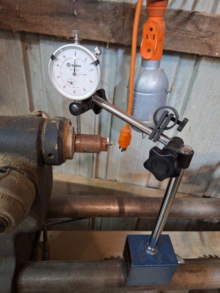

I got curious this evening and put an indicator on the working end of the spindle on my machine. With the belt still on and tensioned correctly, I got just over 0.001 inch of runout, and that could have been attributed to the clearance between the spindle end and the drive spur that was mounted on it.
I then loosened the belt and set up to gently push down on the drive spur then pry up on it from underneath. This revealed a total play of 0.015 inch, not as good as I had hoped. Does anybody have any thoughts on this? Thanks!

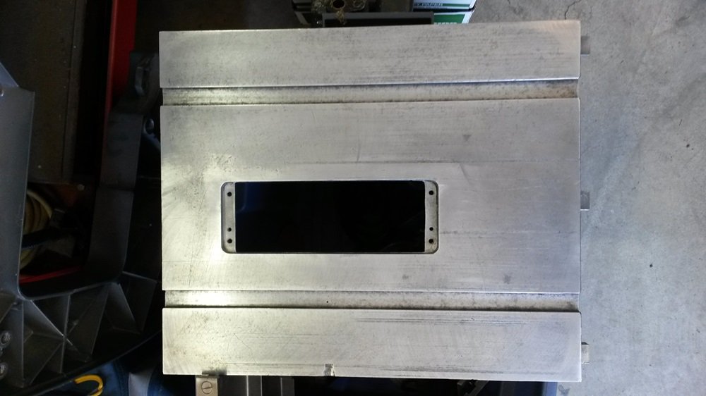

Being from Missouri, I got curious about the two 9-inch table saw blades and mounted one on the machine, followed by the saw table which I had not mounted yet. Sure enough, the blade did not clear the opening in the table, so I took that all off the machine again. Neither of the 9-inch blades appear to be in very good condition, so I'm going to dismount them from their arbors and throw those blades away.
Before I took the table off the machine though, I thought I'd check out the table-raising mechanism to see if that worked okay. The table raising screw did not come anywhere close to touching the table frame where I thought it would hit. I'm attaching a photo of this. What am I missing here, possibly another part? Thanks!

An arm mounts to the table support leg and the screw crank presses against a depression in the other end of the arm. Yep missing a piece. Or it is hiding elsewhere.
FWIW, 8" is the original blade size.

The 9" Saw Blades were used on early Mark 5 Shopsmith's. As you have discovered the 9" blade is too large in diameter. 8" Saw Blades can be found and with carbide tipped ones they cut very well.

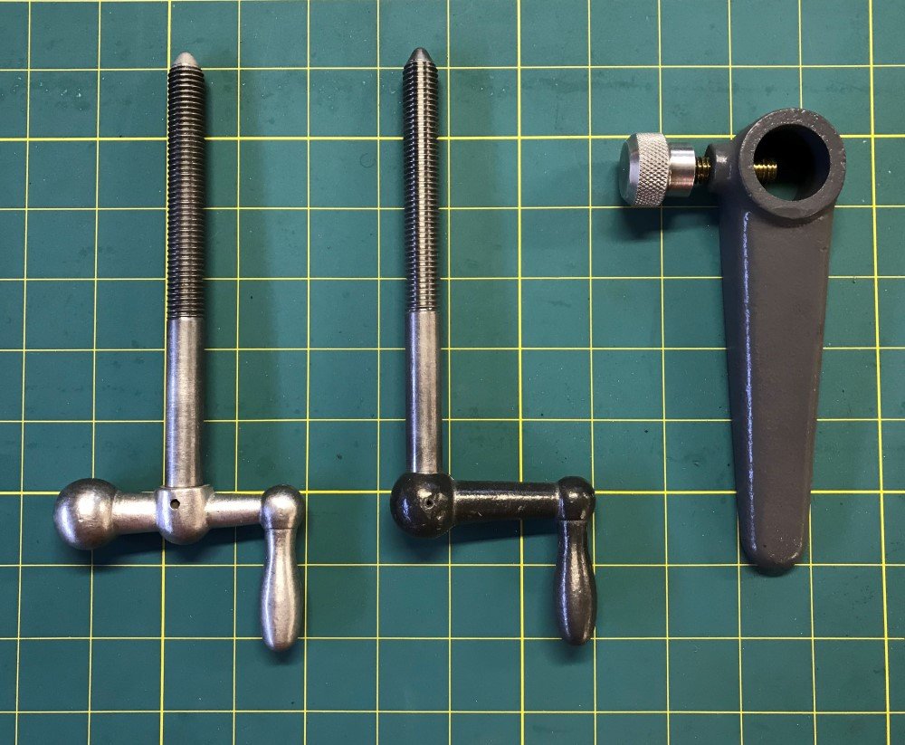

The picture below shows the common Table Raising parts. There were two crank versions and the Arm JPG mentioned is shown too. The arm goes on the front Main Table Post. It is shown in place on page 6 of the Owner's Guide.
