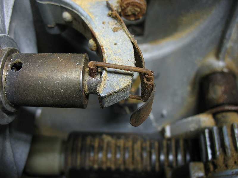

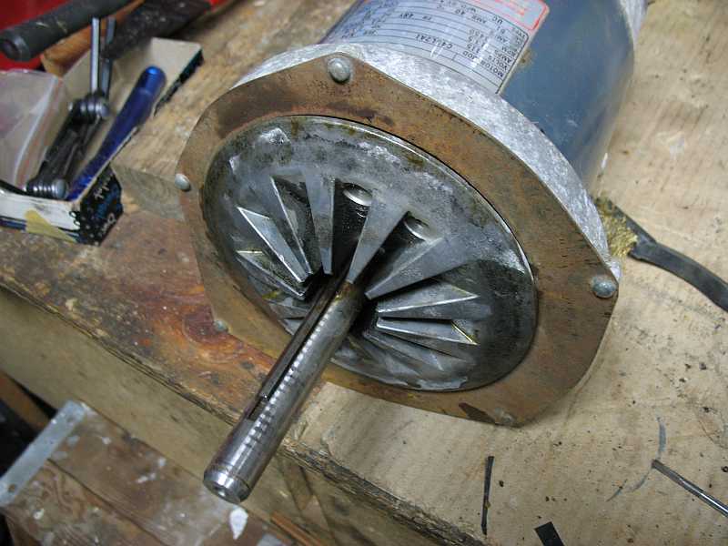

[ATTACH]5513[/ATTACH]
[ATTACH]5514[/ATTACH]

The motor(fan)sheave has a setscrew. look up through the opening in the 'fan' shroud.

Why the pix of the end of the quadrant gear(porkchop)? To separate it from the loop on the end of the control sheave, depress that flat spring with a 'crook' in it and slide the loop off the end. Sure looks like it needs a little oil! It may help it slide. A wire brush wheel(lightly) will remove the top layer of the rust(after disassembly). The loop has a 'spiral' wrapping on the end of the 'loop' which should be free to rotate.

The fan sheve has a set screw right above the keyway slot. So in that pic, it's on top. You'll need a long 5/32 allen, may have to pull the top of the fan sheve out to get it in there.

beeg wrote:The fan sheve has a set screw right above the keyway slot. So in that pic, it's on top. You'll need a long 5/32 allen, may have to pull the top of the fan sheve out to get it in there.
Do not pry on the fan sheave as it bends and breaks real easy. I remove the fan sheave setscrew and put Kroil into the setscrew hole and let set for a few minutes. Then, I find that using 2 large flat bladed screwdrivers by placing one on each side of the fan sheave hub and motor next to the motor shaft. I tap each screwdriver watching that the key does not move past its key way end. I normally clamp this key to keep it from moving and jaming the fan sheave removal. I use the flat side of the screwdriver to start and then the wide side once the fan sheave is moving. I have found several of the fan sheave setscrews loose that destroyed the fan sheave sheave, motor shaft and the sheave spacer. I use blue LocTite on the this setscrew when tighting. The sheave spacer is what keeps the fan sheave about 1/16"-1/8" off the motor housing. Be sure to remove this spacer once the fan sheave is removed as it is easy to lose.
