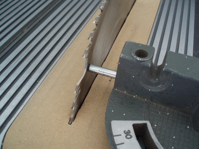

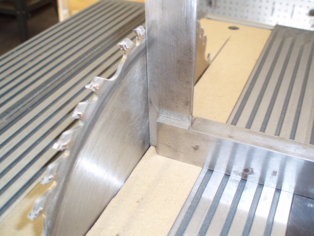

Now, that having all been said, I think it is safe to begin doing the table alignment. Besides, my Wixey (attached to the saw blade) reads 0 degrees. Can you get better than that?
Where Does One Begin?
You are absolutely correct, farmer. One cannot ignore all those simple but possible contributors to an inaccurate cut. Just like one cannot totally ignore run out.
So what must I confirm first in this process.

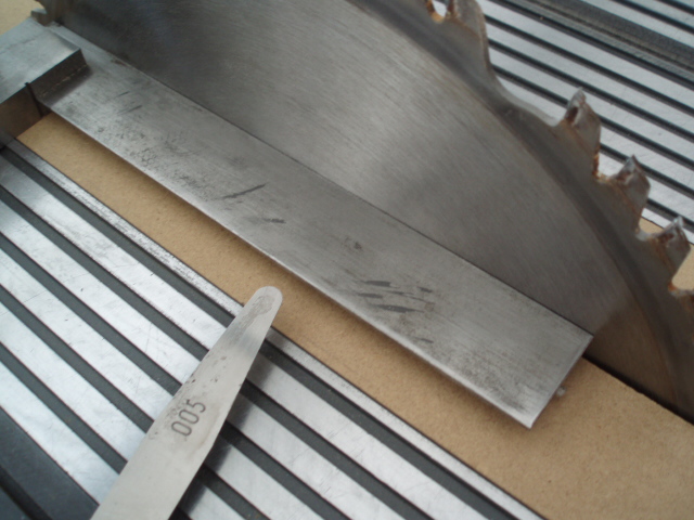

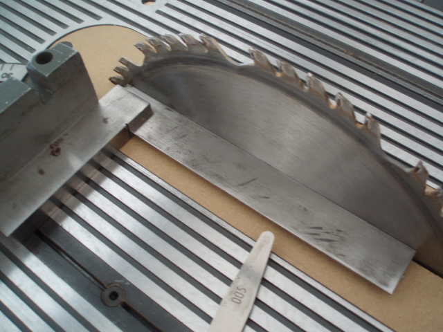

I know that I have about .003" of run out with the arbor and blade that I normally use and I determined that using a dial indicator.

Absolutely. This method of confirmation works with a great deal of precision. If you can not see the gap deviate in size, the gap is not large enough to worry about. Is it less than .001"? Who cares. It is so small that it is of no consequence.
Perfect example of doing precision work without making a measurement.
When I do what you have described on my Mark V, I can visually detect the deviation but it is so minute that it is of no consequence (at least to me). Keep in mind that I know my run out to be on the order of .003" (with this blade and arbor). I have not measured run out at the end of the drive shaft.

Excellent pix Dusty! Cannot help but wonder what those white dots on your miter gauge are.

[quote="JPG40504"]Excellent pix Dusty! Cannot help but wonder what those white dots on your miter gauge are.
RE: Wobble - Unless the workpiece is being fed very aggressively the wobble will not make itself known. The 'high' point will skim off material the full length of the cut. If fed too fast, scalloping WILL occur. Solution: feed slow!]
There is not enough wobble on this blade to be a problem (.003").
The white spots are remnants of a errant spray painting session from many years ago. I have not cleaned up from that session as a continuing reminder (to me) that one really should not spray paint in the shop.
Don't judge anything from the ZCI. That ZCI remains on the table all of the time and has been through many changeovers and blade changes. It does speak well of the rubber ring on the tubes.
When I am doing something where I hope for fine results, I change to a "new" insert and cut a fresh ZCI.
Incidently, if you want to measure the effects of blade wobble, just change to a new insert and cut a new ZCI. Measure the kerf that you just cut (in the ZCI) and then measure the width of the blade (two adjacent teeth). The difference between these two numbers is the result of wobble (your run out number).
