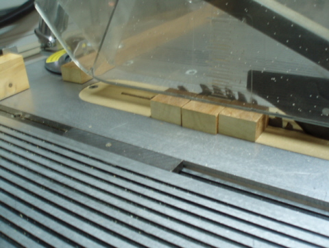

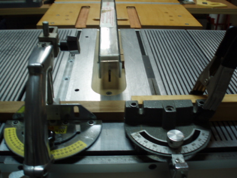

OKAY, here is a quick and dirty solution to the problem. I have to hurry with this because I have gifts to finish building and I don't have a lot of time to spend building jigs.:rolleyes::eek: I looked around the shop for ideas and this popped out.
Use the other miter gauge to hold the stop block. Secure it in the track so that it doesn't move. Adjust the stop block and clamp it to the miter gauge.
[ATTACH]6757[/ATTACH] [ATTACH]6758[/ATTACH]
The saw guard lays on the cut offs until after they clear the blade so they don't have to be removed as they are developed.
We're good to go. Kickback Potential Eliminated! Let's make sawdust and 1 5/8" blocks.
Or are we??? Is there anything wrong with this?

Dusty, what would be the potential for the small blocks in your picture to move and somehow wedge between the saw guard and blade and turning into a projectile? I'm wondering now if that's what happened to me the other day. Perhaps the scrap I was trying to clear wedged between the guard and the blade, was thrown back against push stick (which was pushed against my hand) and hit the inside of the guard with so much force it broke it?
I like the idea of using your SS miter gauge, locked in place, as the holder for the stop block. I wish the miter bar on my Craftsman would lock in place like that! However, I think my personal preference would still be to have a long miter extension with a stop block clamped to it. I've always used the "block clamped to the fence" method until yesterday. Yesterday was the first time I used the "block clamped to miter extension" method and I really liked the result. I had much more accurate cuts, less tear out, and more reliable repeatability as I was able to hold the piece in place against the stop block through the entire motion and cut. But keep in mind, this is on my Craftsman and the miter gauge doesn't have the clamp on it like the SS does. I have a feeling that once I get my Mark V operational, that miter handle/clamp is going to spoil me!
