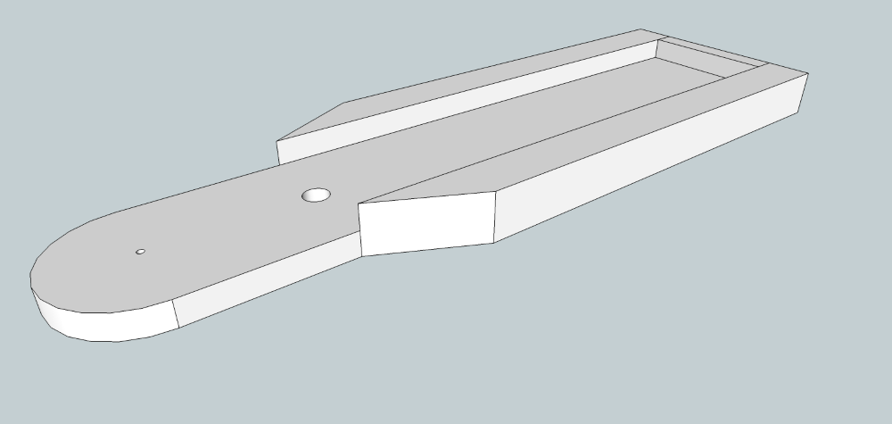

When I make ZCI, I usually do the blanks (if not the complete ZCI) in quantity. To safe some time and, more importantly, to achieve some duplicity, I made a sanding jig. I use it on the belt sander but it could be done just as well on the disk sander.
The one hole (small) is the pivot point and the larger hole superfluous.
[ATTACH]25746[/ATTACH]
ZCI Sanding Jig (Custom).png (46.8 KiB) Viewed 831 times
